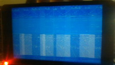

In an attempt to improve performance, I've followed this guide: Changing the Pixel Format of an Application | TouchGFX Documentation to change the pixel format from RGB888 to RGB565. I've also called:
 OTM8009A_Init(&OTM8009AObj ,OTM8009A_FORMAT_RGB565, OTM8009A_ORIENTATION_LANDSCAPE);
instead of:
 OTM8009A_Init(&OTM8009AObj ,OTM8009A_FORMAT_RGB888, OTM8009A_ORIENTATION_LANDSCAPE);
The changes resulted in this beeing display:
Any guidance on how to change the pixel format?
My experience is similar to what is described in this thread: STM32H747I-DISCO 16-bit Color Depth Problem - STMicroelectronics Community

Also, I can confirm that changing the pixel format results in an invalid framebuffer. I will spend some time on it and get back to you with a conclusion.
