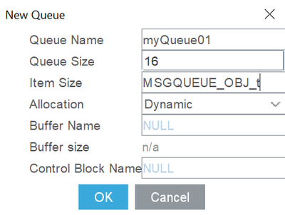

For best practice you want to exit the interrupt quickly. Because you're copying data and transmitting, you could potentially miss more incoming data, and any other interrupts won't trigger, unless you adjust those interrupts as higher priority.
Also i just noticed that you have two HAL_UART_Transmit_IT back to back, so your second transmit may not get sent because the first one is still in the process of sending. So you can either go back to using HAL_UART_Transmit or you can learn to use a ring buffer and queue your messages for transmit.
So i just looked at your other thread. You should follow this example https://www.keil.com/pack/doc/CMSIS/RTOS2/html/group__CMSIS__RTOS__Message.html#gaa515fc8b956f721a8f72b2c505813bfc
And for the queue you would set it up like this
Hope that helps.
