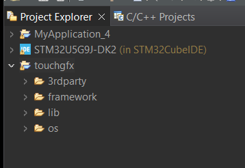

When creating a new project based on STM32U5G9J-DK2, TouchGFX designer defaults the project name to My_Application#, but when the project is generated it' still based on the TBS default package name of STM32U5G9J-DK2.
This seems to cause issues when opening the .ioc project in STM32CubeIDE, because the .ioc is still named STM32U5G9J-DK2.ioc and not the same as the application name:
There are further issues with the linker file not matching, and a sub project being created with the name STM32U5G9J-DK2 and then main.c and other files in the sub project being used for build.
This seems to mean that if you have an actual project named STM32U5G9J-DK2 (e.g. the demo) and then created a second project named MyApplication_4 when you try to compile MyApplication_4, files from STM32U5G9J-DK2 project will be used.

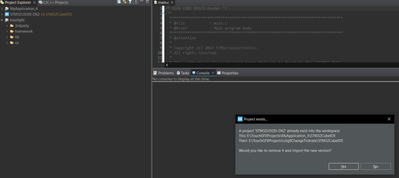

Hello @ARM_and ,
If I now create a new STM32U5G9J-DK2 called MyApplication_4, I can then open the STM32CubeIDE folder and then open the .project file, then STM32CubeIDE will try to open the new project that has the same name so there is a conflict.
I then get prompted to close the previous project because there can only be one project with the same name open at once.
I can then build and flash as usual.

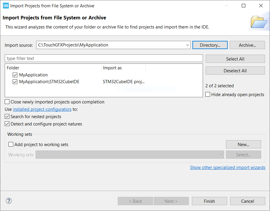

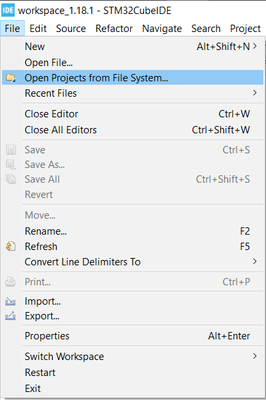

Hi @GaetanGodart
I open project from the file system:
And then:
And then it makes a mess of it :)
This is not a huge issue since if we start a named project from the STM32CubeIDE/MX side, then TouchGFXDesigner can open it and add GUI code and the round trip to the IDE is fine.
It only happens if we need to open multiple DK2 based projects in STM32CubeIDE I guess.
Hello @ARM_and ,
Indeed, opening projects with "Open Projects From File System..." seems to be problematic, here is what I get:
But when double clicking on the .project file to open it, it works correctly in STM32CubeIDE.
I get prompted to remove files which are conflictual (same name):
Which makes STM32CubeIDE clean the workplace.
I recommend you to open projects by double clicking on them (.project file) in the file systems explorer.
