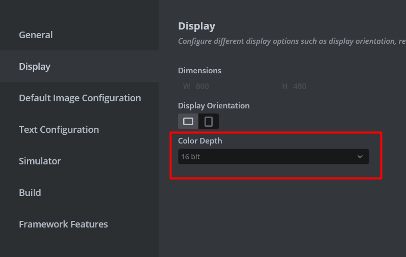

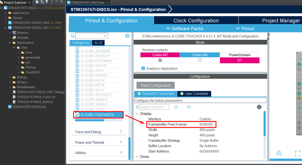

To change color depth to 16-bit, firstly I am changing Framebuffer Pixel Format section to RGB565 like in the below:

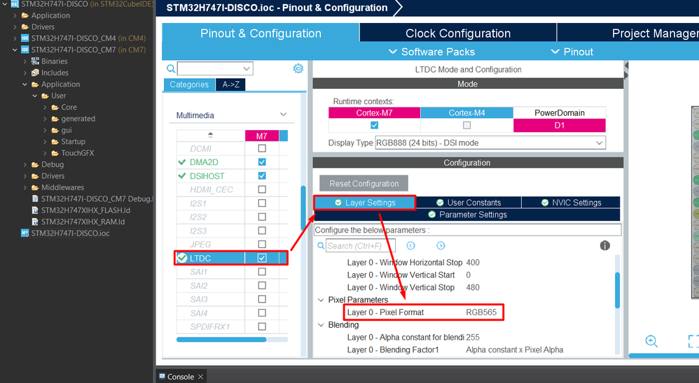

Then I am changing the Layer 0 - Pixel Format section to RGB565 like in the below:

Later, I am opening touchGFX project and as you can see it is 16-bit now.

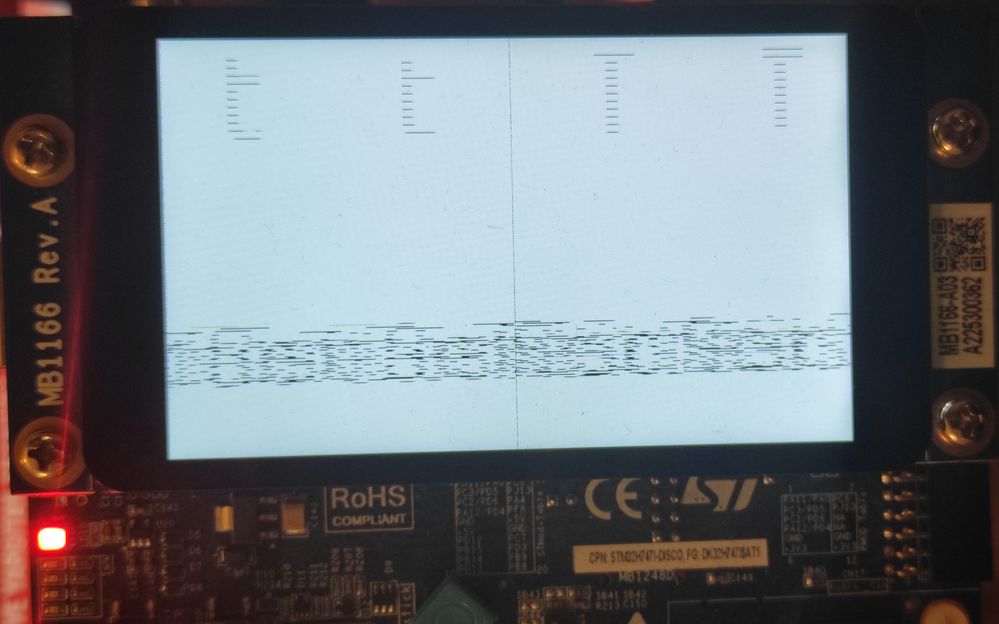

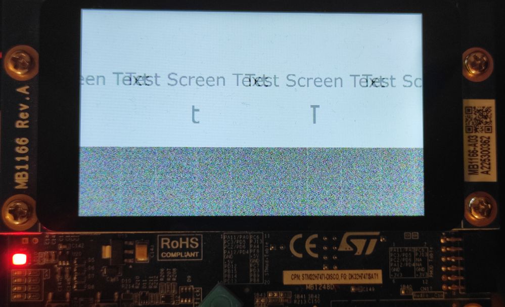

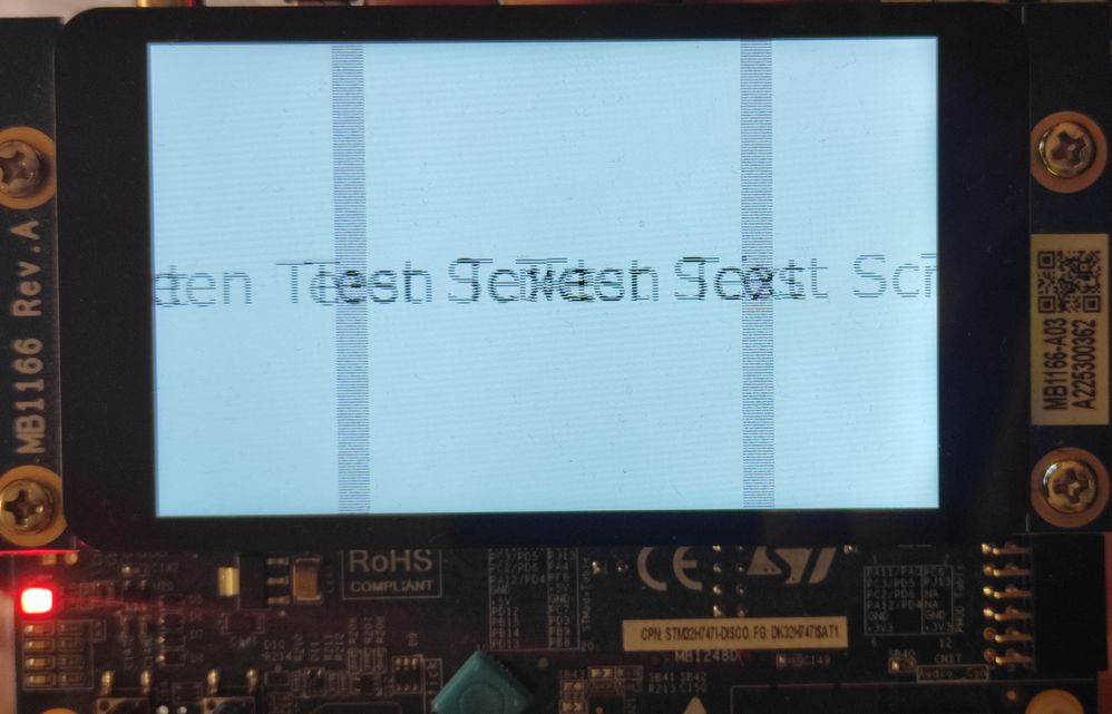

Then I am pressing "generate code" button and finally, i'm downloading new 16-bit project to stm32h747-i disco but it shows me this screen when I try to use 16-bit color depth. It fails.

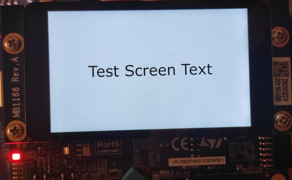

However, when i use 24-bit color depth, it shows me this screen as expected and works without any problem!!!
How can I use STM32H747I-DISCO development board with 16-bit color depth? What am I missing? What should I do? Thank you for all answers!

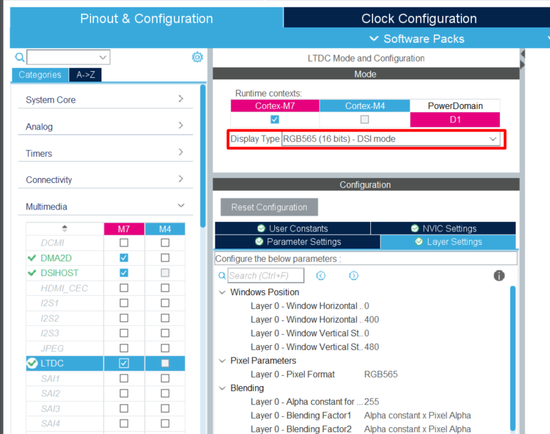

As your suggestion, I changed Display Type to RGB656.

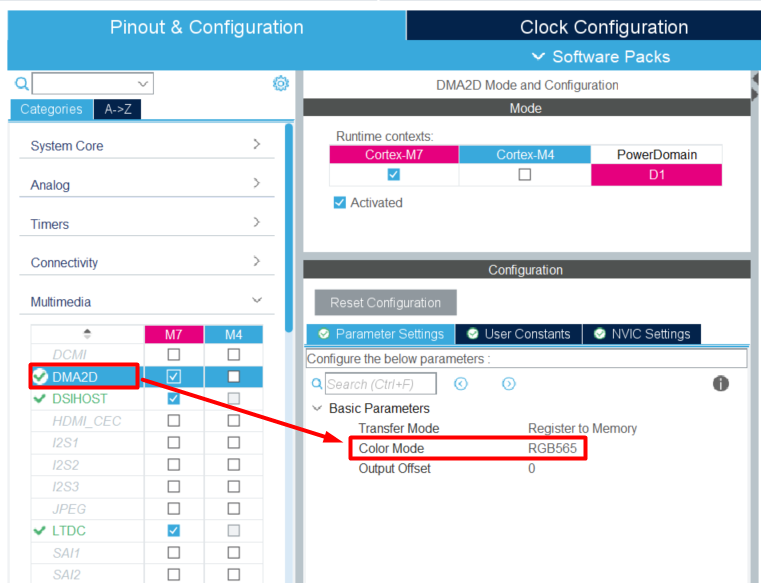

Then I changed DMA2D Color Code to RGB565.
Unfortunately it didn't work.
