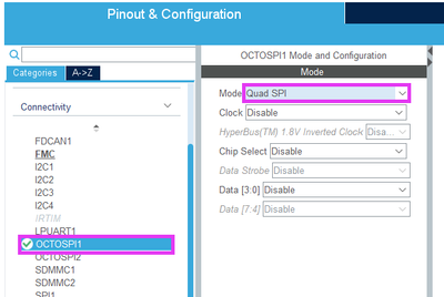

When i use X-Cube-Display->Board Part->Memory->Custom: OSPI, the "parameter settings" for external memory parameters tell me that bus type is "octo SPI", but the Instance says "Unavailable Quad SPI Mode", OCTOSPI1 is configured as Octo SPI. I dont get how i set it to OSPI and then it asks for a Quad SPI.

The STM32U575 MCU supports the OCTOSPI interface. So, you can't select an QUADSPI interface in the X-Cube-Display.
For that, in your case, it should be selected OCTOSPI interface in X-Cube-Display->Board Part->Memory->Custom: OSPI and set the OCTOSPI as a Quad SPI Mode.
