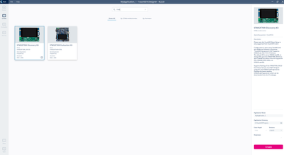

Hello @Kyrpav,
The easy way to start is to open TouchGFX Designer and select the appropriate TouchGFX Board Setup.
In your case it is the STM32F769I Discovery Kit :
Then, you can either start a blank application by click on the "Create" button, or navigate to the Examples/Demo tab to start your application with a example project.
After creating the project, it should already contain the basic software and hardware configuration required to make your project run on the board.
If you want to run your project in STM32CubeIDE, you only have to click on the "Generate code" button in TouchGFX Designer :
You should be able to compile and run your application with STM32CubeIDE after that :)

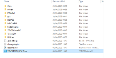

If you want to change something in your hardware/software configuration, you have to open the .ioc file of your project in STM32CubeMX. For that, you can simply double-click on this file at the root of your project :
Don't forget to regenerate code with STM32CubeMX after modifying something there.

‎2023-06-20 9:33 PM
Ok after step 2 add run on target test if all works.
Import how, i use way create empty workspace in IDE then double click .project file in right project folder.
No edit in MX , this dont work and corrupt 50% touchgfx generated projects.
For next edititng no open part file , but touchgfx file (part is recreated from MX ...)
edit files in IDE and build you can in both systems only if not files add. After new files you can build only in IDE.
Too load only from IDE then. And for discovery with external flash you need config loader...
All your points from 3 up is for advanced users.
And if you need manage ioc , then steps is complete different and more advanced.

Please note Yoann's advice to open .ioc file on the stand-alone cubeMX, not in the integrated version in IDE. (Name of ioc differs from project name so it wont open from IDE).

‎2023-06-22 7:40 AM - edited ‎2023-06-22 8:15 AM
Irelevant where yuo open ioc = project is corrupted after regenerate code.
And aroung TouchGFX i say about 3 buttons generate simulate run on target.
Normaly you can use all, except you add files and code that block last two. Only generate then is used .
After generate changes in GUI swith into IDE and build load here.
