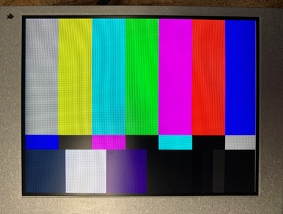

My TouchGFX application is outputting a static image in the GUI wrongly and I am unsure where the error stems from.
Board: STM32H747I-DISCO
Display: Innolux G057VCE-TH1   (640wx480h RGB666)
Without TGFX, I am able to output a chosen static image array correctly, and when it is on external memory. Thus, I believe my configuration for the LTDC and FMC is correct. When using TGFX, I set up breakpoints for the LTDC FIFO underrun interrupt handler, and it was never triggered.
In TGFX Designer, whether I have the orientation as portrait or landscape, and fill it with the image filling the screen, the output is the same.
This project was initially generated from TouchGFX Designer for the discovery board, and I gradually modified it to accommodate this display. An important change was commenting out DSI and old display controller calls (this new screen does not have a controller, it just uses parallel RGB).
When I am debugging, the program does not run into any infinite-while-loop error handlers.
I inspected the generated cpp array of the color bars image and they seem to be fine.
What I notice from the image is that vertical lines are now drawn horizontally and at a slight angle downwards. Instead of gray, yellow, cyan, green, purple, red, blue from left to right, it is now drawing that progression of colors line by line downwards. This is why I suspect that the problem lies in some orientation configuration affecting how the TGFX engine draws pixels to the framebuffer.

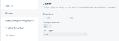

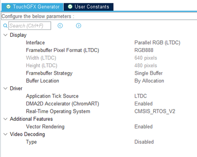

How you have set the display dimensions and color depth when you create project with TGFX designer ? This setting must match your display layout.
Changing horizontal or vertical orientation doesnt help you, problem is 'deeper'. With working configuration you can select any of those and picture is show right (I mean picture is not distorded).
Br J.T

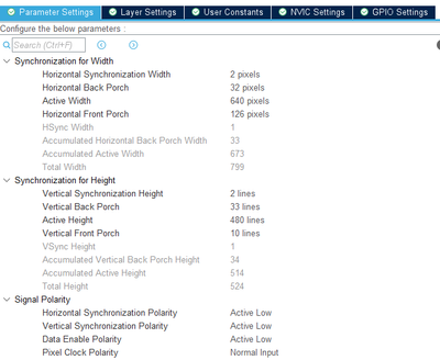

The project was created for the DISCO board, so those settings were not the same. I updated the LTDC and TGFX settings in CubeMX, and those changes are reflected in what Designer shows. Not shown in the screenshots is that the LTDC GPIO speed are all set to very high.
StephenG
Designer showing the right display dimensions:

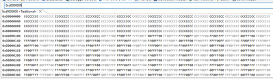

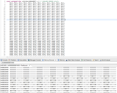

I have already tested the manual framebuffer plenty of times.
However, in the IDE I am not able to inspect memory contents, they are all question marks. When I did not involve the FreeRTOS and TGFX, I was able to inspect memory. So what I know is that the image files generated have the correct data, the LTDC is able to take whatever is in the framebuffer and put it out to the display if the data is correct, but what's left is I don't know the data being put there in real-time.
I was able to inspect the leftover memory contents of the TGFX framebuffer location the next time I used a manual framebuffer location, and it appears that there are the same, correct contents. This may be suggesting that the TGFX engine output may be correct.
Manual framebuffer and data:
