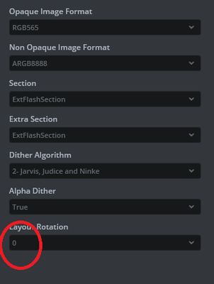

‎2023-08-08 12:13 PM
One more idea, what about this setting, it must be 0. It seems mix images wierdly if 90.
Maybe its worth testing put some box etc to tgfx also.
‎2023-08-09 6:18 AM - edited ‎2023-08-09 7:55 AM
Yes, using both the portrait or landscape option under Display Orientation will also change the Layout Rotation, and using both versions as shown in my first images produces the same output image.

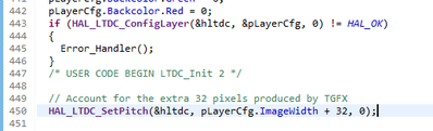

‎2023-08-09 9:26 AM - edited ‎2023-08-09 10:25 AM
Do you find HAL_LTDC_SetPitch - call on LTDC initialization, what it looks like ? Put there this 672
‎2023-08-09 11:46 AM
Yes, putting this after the LTDC init functions corrects the image. I still do not know why TGFX adds the 32 pixels of bogus at the end of each line.

‎2023-11-08 5:21 AM - edited ‎2023-11-09 4:56 AM
Looking a bit further into this issues I found the actual cause.
Just like the topic starter I am using an example generated TouchGFX application for a Discovery board.
This example used DSI and now I am converting it into using RGB.
For some reason when using DSI, the width passed to the TouchGFXGeneratedHal is the screen width + 32.
So in the file target/TouchGFXHAL.hpp in the constructer this +32 was added.
TouchGFXHAL(touchgfx::DMA_Interface& dma, touchgfx::LCD& display, touchgfx::TouchController& tc, uint16_t width, uint16_t height)
: TouchGFXGeneratedHAL(dma, display, tc, width + 32, height)
This causes the 32 extra garbage bytes in the framebuffer when switching to the RGB interface.
To get the images to show properly on the display I also had to change the Layout Rotation from 90 to 0 in the TouchGFX designer:
config -> Default Image Configuration -> Layout Rotation.
