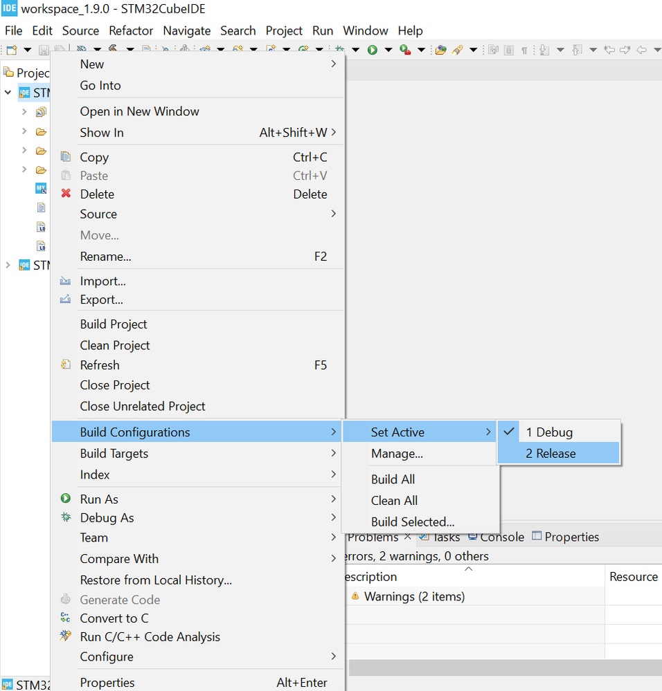

Can you share with us the error logs you have when you click on running on target with TouchGFX Designer ? Have you tried to run your project with release mode instead of debug mode within STMCubeIDE ?
/Osman
Osman SOYKURT
Thanks for reply, Osman.
Share the error log that occurs when you click Run on Target.
However, there were no error and warnings.
As you told me, I tried building in release mode instead of debug mode, but it didn't work. (It looks that only the capacitive touch sensor is not working) The hex file at this time is also shared.

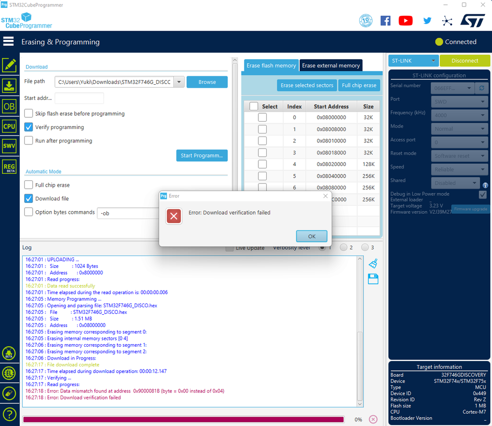

Hello Osman,
Thank you for all the validation you have done.
I bought two more boards of the same revision and wrote the HEX file but it didn't work ...
STM32CubeProgrammer has a "Verify programming" function, but when I turned it on I got a verify error.
I have replaced the USB cable for writing, host PC, etc., but it always seems to get a Verify error.
0693W00000Nqnm0QAB.pngAlso, I will send you a log of the writing process.
Is there anything you have noticed about these?
Yuki​

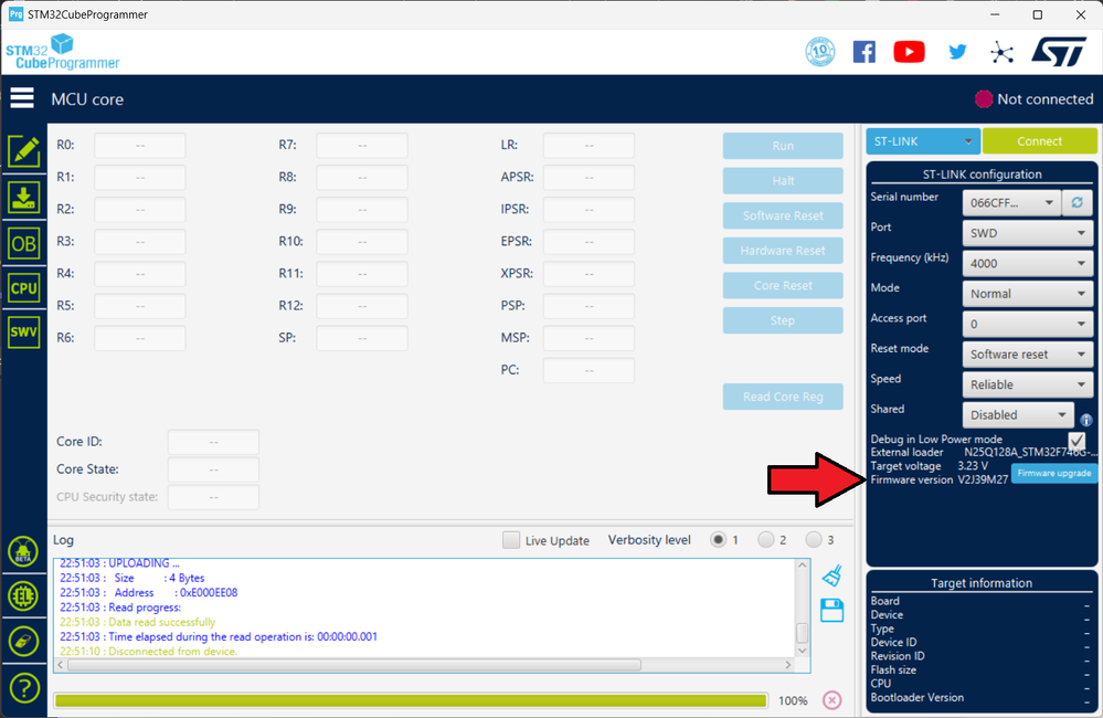

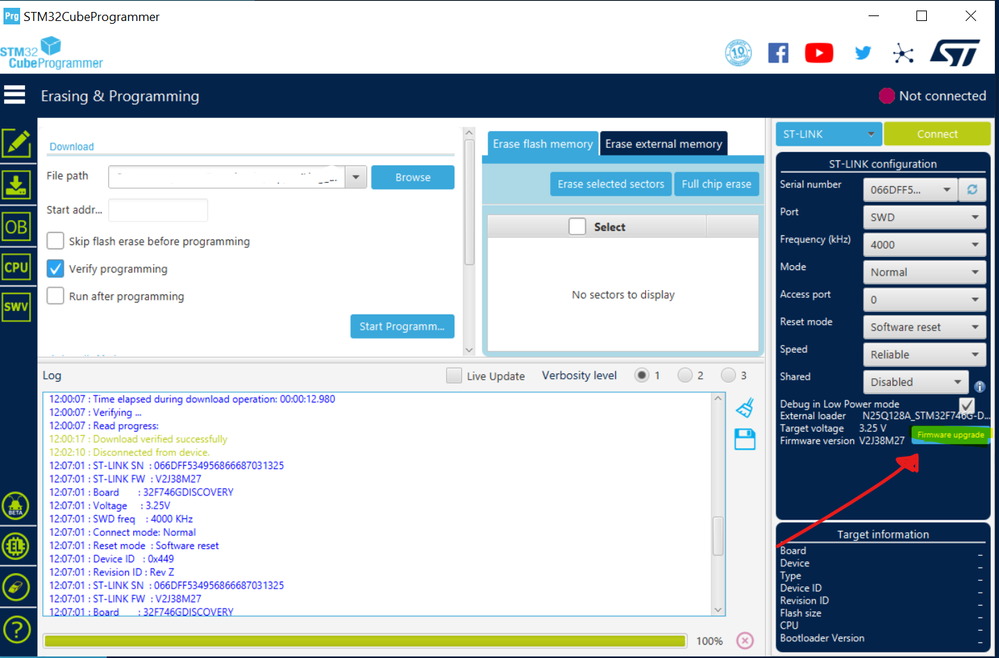

Yuki
Hello Osman,
The firmware upgrade had already been performed.
I noticed two things from the pictures you sent me:
1, I did not specify External Loader in my environment. I found a way to specify it, did it, and the validation error stopped happening! But the problem of the board not working independently remained the same...
2, The ST-LINK firmware versions that come with my boards are all V2J39M27, but in your environment it appears to be V2J38M27.
Is there any possibility of this version difference?
Yuki
Hello Yuki,
Great to hear that the problem with validation error is resolved!
Indeed, the external loader is mandatory when we download the application on the board.
For your second remark, unfortunately it's not the problem. I did try with V2J39M27 with my board, and same result, works fine.
Do you know if it's only the "touch screen" that doesn't work, or your application is totally freezed? Can you try to add animation in your application (like a box that moves for example). You can try with the application I share.
Also, another idea would be to debug with CubeIDE using breakpoints to see in which functions it go through and in which on it stops.
/Osman
