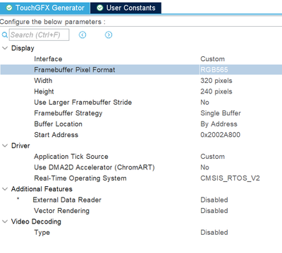

Here is my configuration from CubeMX:
So I believe that there is something in TouchGFX that is not setup correctly. But I cannot locate the problem as the  TouchGFX is a blackbox.
