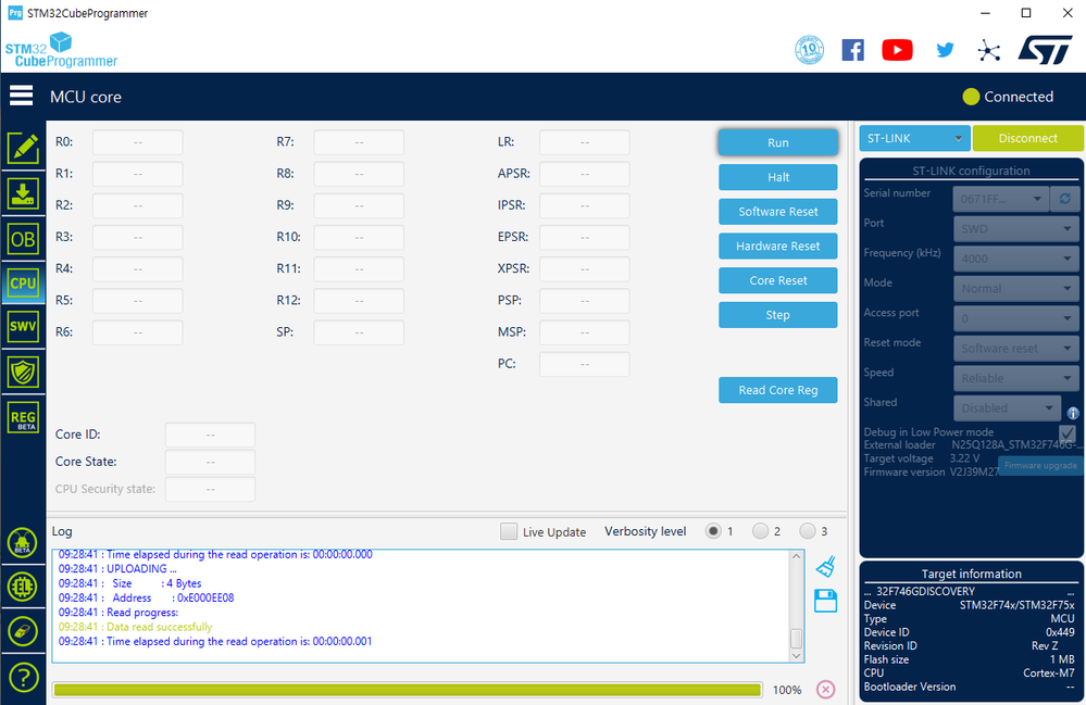

I have the same problem.
Only the "touch screen" doesn't work.
My board doesn't work with hardware reset, but it works with STM32CubeProgrammer.
0693W00000WIjUFQA1.pngWhat is the reason for this?
Hello Paphael,
A solution is shared in this thread.
/Osman
