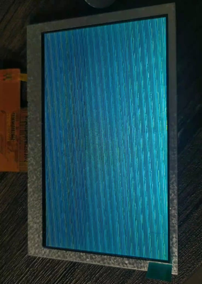

I'm using a custom H7 board, with QSPI + 16-bit SDRAM, and using RTOS.
However I run into an issue where there's glitching in my gauge in TouchGFX (see attached video...)
TouchGFX is using double buffer, also animationStorage:
setFrameBufferStartAddresses((void*)0xC0000000, (void*)0xC0177000, (void*)0xC0400000);
A few points:
- I'm able to read/write to QSPI & SDRAM correctly
- Static images appear correctly
- Glitch also appears on the whole screen during transition from one image to another

if you are being able to see proper GUI without animations, but when changing from one to another screen and getting a glitch, i have solved it from different sources:
it happened to me once with wrong MPU and Cache configurations.
Then, it happened to me also with a wrong SDRAM configuration, in this case i did not have glitch at all, but something like "lossing frames"
And the last time i had it, i have provided more memory to heap/stack(talking about the RTOS task memory, the touchGFX task). I am not the best coder, so i made some kind of spagetti and was destroying the memory, i noted and provided more memory, it wasnt the cleanest, but worked.
Greetings
Yes, the framebuffer swapping works OK, I've checked this using the oscilloscope and swapFrameBuffers() is called. This is the glitch that happens during the transition between two images (screencapture):
Thanks for the reply.
I think the SDRAM is already functioning properly, as data is written without corruption, and static image is not corrupt as well..
For RTOS, we are using TOTAL_HEAP_SIZE = 40000 Bytes and touchGFX task has a stack size of 8192 Words.
Could you please tell us where the MPU and Cache configurations might be wrong? We've tried so many combinations for the MPU and it's still not working..

Not yet, unfortunately. We suspect there's a problem with the LCD framebuffer as the LCD we're using is not branded, so we're looking for a different one. We'll keep this thread updated.
We have just tested with a different LCD, the problem still persists.
Attached is the result when I put .png images in TouchGFX, whether in internal or external flash. Rotation of the images are 0 degrees.
Why aren't they being displayed correctly?
