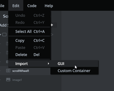

I noticed that you mention using a new board. You also say that creating a new project from TouchGFX Designer 4.24.2 works fine.
Can you check which version is that board and which version was the previous one.
There was a major change in the board revision CU4 and later uses a new memory.
If that is your case, the simplest way to fix it is to create a new project and then clicking on "Edit" => "Import" => "GUI".
If you have a complex project where there is code outside of the TouchGFX scope, either you have to manually add it or I could maybe provide you with the git commit change that switch from the old memory to the new one.
