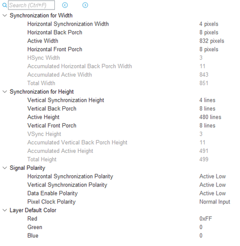

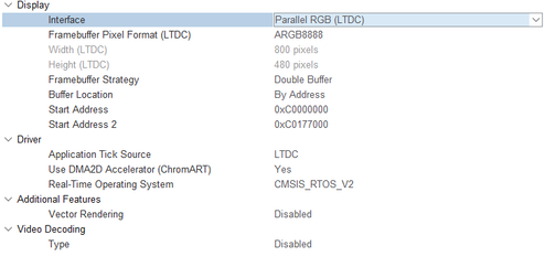

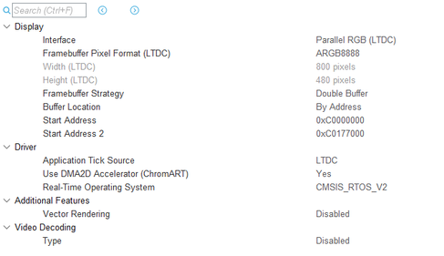

My LTDC & TouchGFX Configurations:
Can anyone please tell me why this happens? Thanks..

2024-12-06 10:58 PM
Okay, I got it to work but without the DMA2D, and I switched to RGB565.
I also did these, which removed the glitches and artifacts:
- Initialized FMC_NBL0 and FMC_NBL1 pins (crucial, as it turns out...)
- Set MPU of the SDRAM to:
MPU_InitStruct.BaseAddress = 0xC0000000;
MPU_InitStruct.Size = MPU_REGION_SIZE_32MB;
MPU_InitStruct.IsCacheable = MPU_ACCESS_NOT_CACHEABLE;- Disabling the DCache also helped during troubleshooting.
Thanks to everyone who has helped answer.
