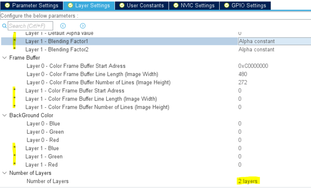

I am new to TouchGFX, so I am starting with something simple, displaying an image on the screen. I am using a custom STM32H753 board, where the display is hooked up through the LTDC interface. The display is working properly; when I write manually to the frame buffer, then the data gets displayed correctly. I was using the TouchGFX designer to create the screen with the image, and I set it as boot display. However, the image never appears on the screen. I checked that the task for touchgfx is created and also entered. Also the LTDC line interrupt is generated correctly. I am not sure in which part of the code, which TouchGFX is generating the actual drawing take place. So far I could not locate any code, which actually draws to the frame buffer. I found some shells for drawing functions, but they are all doing nothing. So something seems to be fundamentally wrong here, and I am missing the starting point where I can look. Can someone give me a hint why I am not getting anything drawn on the screen?

One thing that might be an issue for some board is that CubeMX generates code for the second layer, which should not be generated. So if you have a problem, set everything to 0 for this layer. It is called Layer 1 (and the first layer is Layer 0). You will find the Layer settings in the LTDC settings.
Please refer to the image below.
