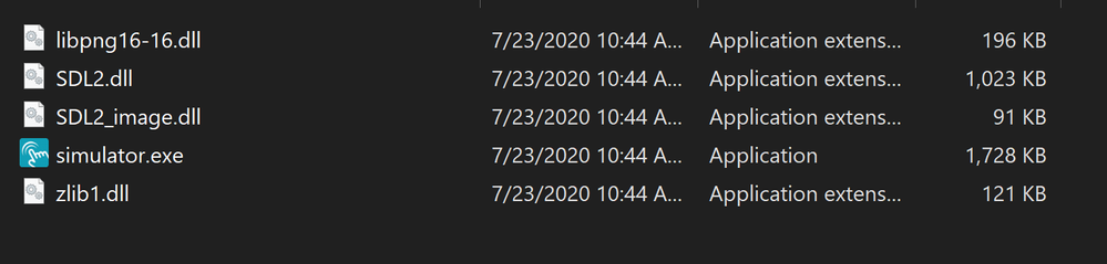

Hi, How to create/generate an .exe file for my TouchGFX application using TouchGFX Designer?

What are you trying to achieve? Do you wish for a binary file (elf, hex) for your UI project done through Designer that you can share to people so that they can test it directly on their boards?
Please give more details on what you are doing, I would like to understand why you are looking for an .exe file.

Yes, I want to share the binary so that people can test them.

To do so, just archive the entire folder bin in ./build/bin. The .dll files are necessary for the simulator.exe file to run correctly. Then people can retrieve the archive and double-click on the simulator.exe.
Here is how it looks like :
