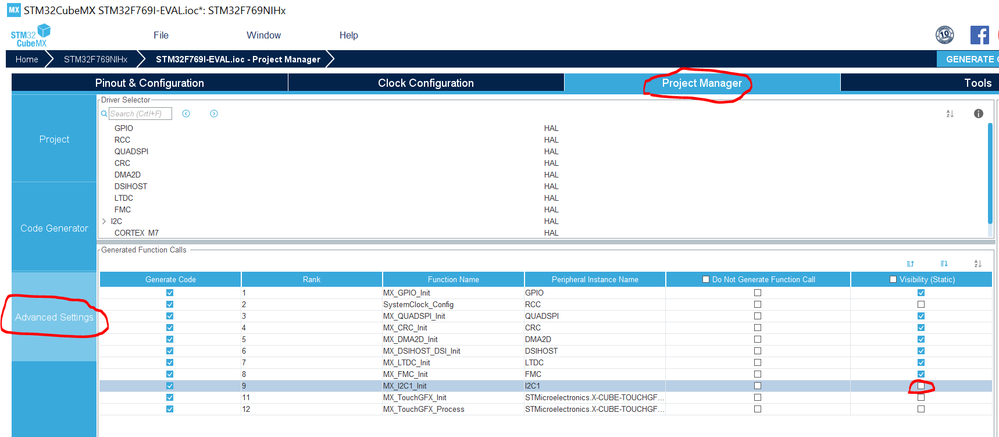

It is because I actually received the same question earlier today and am working on it right now :grinning_face_with_sweat: There seems to be an issue with the application template available in TouchGFX Designer and the latest revision of the display (the A03) where the board goes to hard fault when the touch panel is initialized.
We are still investigating but in the meantime here is a workaround:
- replace the STM32TouchController.cpp and hpp files in the TouchGFX/target folder of your project by the files I shared
- open the ioc file in STM32CubeMX and go uncheck the box like in the screenshot to remove the "static" property of the MX_I2C1_Init() function.

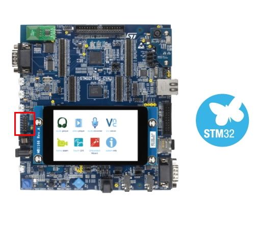

Could you make sure the jumper is set at the right power source (needs to be st link) ? It is on the left of the screen.
The AT works on the boards I have, but just to align on the boards what REV is yours?
