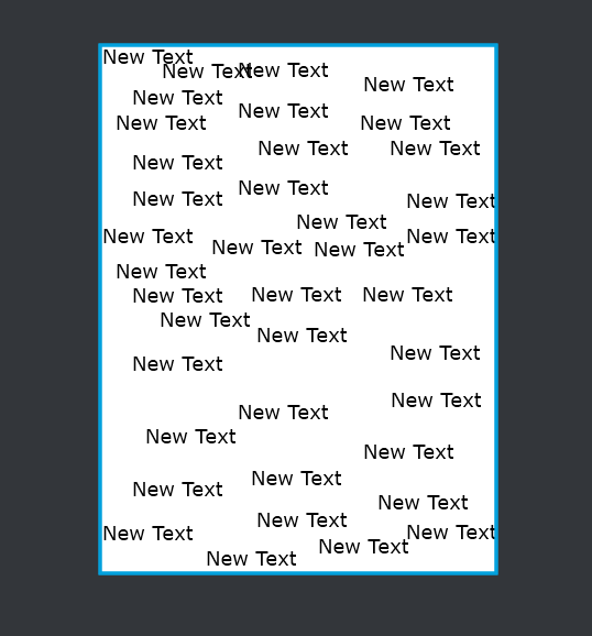

Im looking to add a page with multiple test boxes,as i need to update sensor readings to the screen. Originally i built this in custom containers as i would normally, but it kept crashing on creating on the new page. So i have worked back making the page more and more simple untill i found a threashold of it occuring when i have 38 default text boxes on the screen (see pic), the text boxes have no buffers allocated to them and this is on a fresh screen so no functions or code running.
if i lower the number of text boxes to 34 its fine.
is this a limitation of 4.20 ?

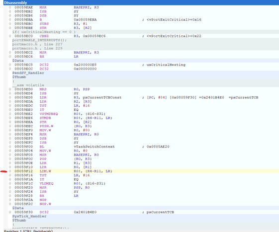

I've tried increasing the canvas buffer and rtos heap and task memory but nothing resolves this crash (HardFault exception), i've attached the memory address in the diassembler.

Gfx allocates memory neccessary for its operation automatically at compilee time so there should not be a problem.Very difficult to tell what is going on. 10k does not seem much RAM. How much RAM you've got ?
Maybe try to enable freeRTOS config option configUSE_MALLOC_FAILED_HOOK and see if your program get to call error handler call.

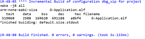

When you link you app what does console say about ROM/RAM usage
Im running an STM32H757 so i should have pleanty of RAM

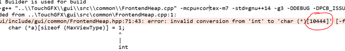

This is the crutial point - Heap of Gfx is sizeof biggest screen/view. By removing screens you are surely lowering ROM footprint, but not necessarily RAM footprint.
To see Gfx Heap size, check sizeof 'MaxViewType' e.g. in FrontendHeap.cpp:
char (*oi)[sizeof (MaxViewType)] = 1;
