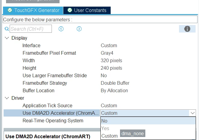

I am trying to use the ChromART accelerator foor my touchgfx project hacing the display on the SPI line.
However, while I am enabling the TouchGFX, I also wanted to enable the use of ChromART DMA for a grescale display. But the, the STMCubeMX does not allow me to enable the ChromART if I select "BW" or "Gray 2" or "Gray 4" pxel format. Kinldy suggest.

To use the DMA2D Accelerator (ChromART), you have to select one of the supported Pixel Format (and Enable DMA2D for sure). For BW, Gray2 and Gray4, it seems to be the not supported Pixel Formats.

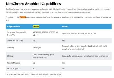

Sorry for my late reply. Here are the Supported formats (with TouchGFX) for the DMA2D:
You can find this table and more on this link: TouchGFX on NeoChrom/NeoChromVG | TouchGFX Documentation
