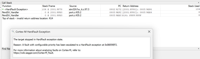

I have a custom board project which I have been running for over a year and im looking to add some features to the layout. The screen is a 240x320 layout and the MCU is a STM32H757. I am running touch GFX 4.20 and it will be difficult for me to upgrade from this due to the ties within the cubide and code base.
Im looking to add a page with multiple test boxes,as i need to update sensor readings to the screen. Originally i built this in custom containers as i would normally, but it kept crashing on creating on the new page. So i have worked back making the page more and more simple untill i found a threashold of it occuring when i have 38 default text boxes on the screen (see pic), the text boxes have no buffers allocated to them and this is on a fresh screen so no functions or code running.
if i lower the number of text boxes to 34 its fine.
is this a limitation of 4.20 ?
I've tried increasing the canvas buffer and rtos heap and task memory but nothing resolves this crash (HardFault exception), i've attached the memory address in the diassembler.
Im running an STM32H757 so i should have pleanty of RAM
I think i have managed to resolve this. I changed the following task buffer size. this was originally 1024. no changing it to 2048 i've not seen the crashes.

Hi @justin11 , what does function call stack say ?
justin11
Senior
This is the call stack at the point it crashed

72 == sizeof ( touchgfx::TextArea )
72*34 = 2448 bytes
So you are creating them on heap. Does this happen if you add them from an array of lets say 50 TextArea ?

I am not aware of any limitation on drawables added to a screen. Maybe you exhaust your RAM ?
You could check size of screens. This compiler error will tell you the size
char (*ee)[ sizeof ( Here_name_of_SreenView ) ] = 1;
When using the command i get a result of 8396. This is actually now on a different page, which is also very much on the edge of the crash threashold.
Where should i look to increase any memory allocations ? should i be looking in the touchgfx project or freertos ?
