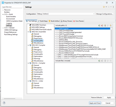

STM32CubeIDE automatically searches for header files in all the directories listed under "Include paths" in the project setting, as shown in the screenshot below. So you just need to place the header file in the folder you wish and make sure that this folder is in the list. Be aware that there are two separate lists for  c and cpp compilation.

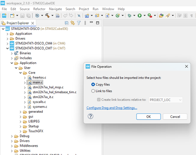

.c and .cpp files generally need to be explicitly added to the project. This can be done by dragging-and-dropping a file from the Windows file explorer into the project tree in STM32CubeIDE, like shown in the screenshot below.

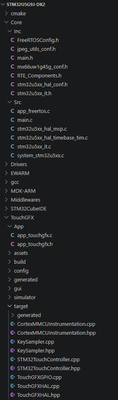

If look at our example projects available in TouchGFX Designer, to can e.g. see that the core files generated by STM32CubeMX is split into Inc and Src folders, while X-CUBE-TOUCHGFX places header and source files in the same folders:

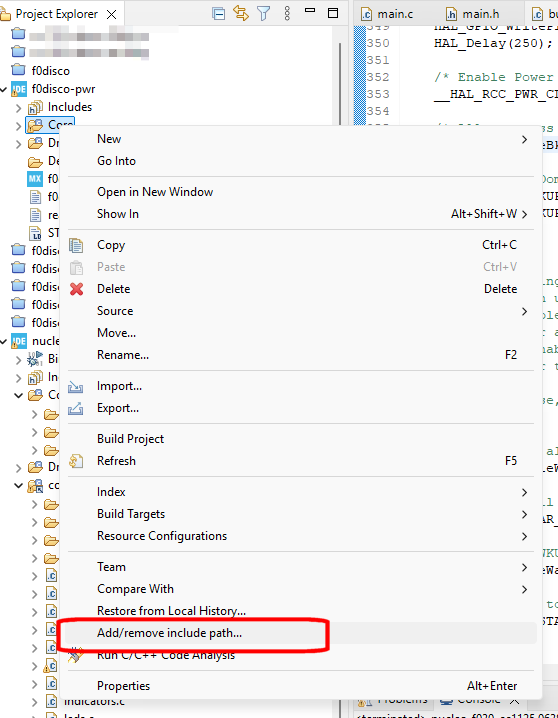

Note that you can add a folder to the Include Paths by right-clicking it, and choosing 'Add/remove Include Path...'
