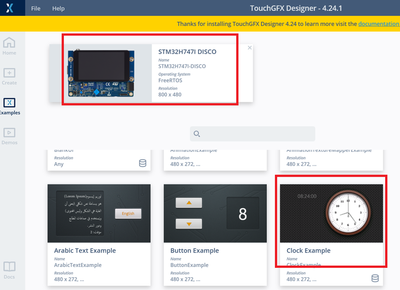

Could you please tell which "Clock Example"  you are referring to?
I use this combination
