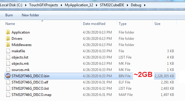

Binary File Created in Too Large ..
1) STM32F746G_DISCO.bin        2.12 GB
STM32F746G_DISCO.elf         239 KB
STM32F746G_DISCO.hex         99 KB

As Martin KJELDSEN already explained previously : ".bin files will be huge because they're covering memory area all the way up to external flash 0x90000000. That's a lot of 0s !"

No it's not a bug. It's normal. You shouldn't use the .bin file.
The only interesting files are .elf file and .hex file to download you project into your board.
You can remove the generation of the .bin file by unchecking the option in the project settings.
