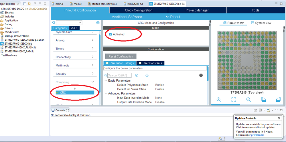

@Martin KJELDSEN (ST Employee)
OK .
startup_stm32f746xx copied from.
C:\Users\Gurpreet\STM32Cube\Repository\STM32Cube_FW_F7_V1.16.0
I have created Project from TouchGFX 4.13.0 . The Steps Mentioned by Alexandre RENOUX (ST Employee)
Yes .. CRC is Already Enabled ..
Still Having HardFault ..
How I will ?
Is this a Bug or What ?? How do I resolved that .. ?
