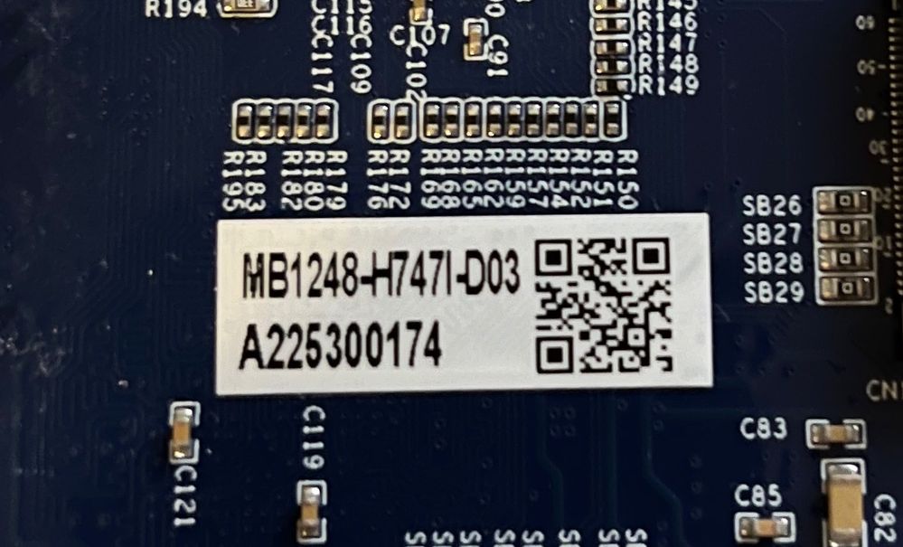

I also tested BSP with LCD rev A03 and board D01
EDIT: LCD_DSI example tested with board RevD01 and RevD03
Could you please check the board revision (Under LCD)
‎2023-03-10 9:30 AM
D03 here​

‎2023-03-10 9:38 AM
DO3 here.
Board was from Mouser, there is also another guy having issues which may be related, also from mouser: https://community.st.com/s/question/0D53W00002ASl3lSAD/stm32h747-discovery-blank

Yes, I have the same board. The only difference that I see is in the sticker with the QR code. In mine is A225301364
