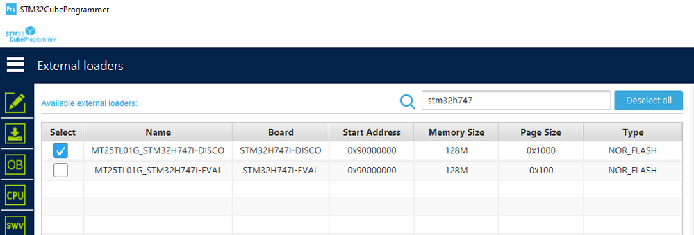

I don't see any mention of selecting an external loader?

If you're using Cube Programmer to program the bin, then try selecting a memory device

Thanks. I have been using the correct External Loaded, it doesn't make a difference.

  4. Using the correct External Loaded does not fix the issue.
