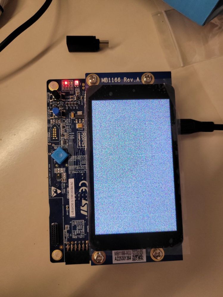

When I flash some .bin the LCD doesen't work. It just display the a noise picture. With similar examples does work and with more advanced examples like the EmbeddedWizard it works too.
When does not work, every time display the same static image:

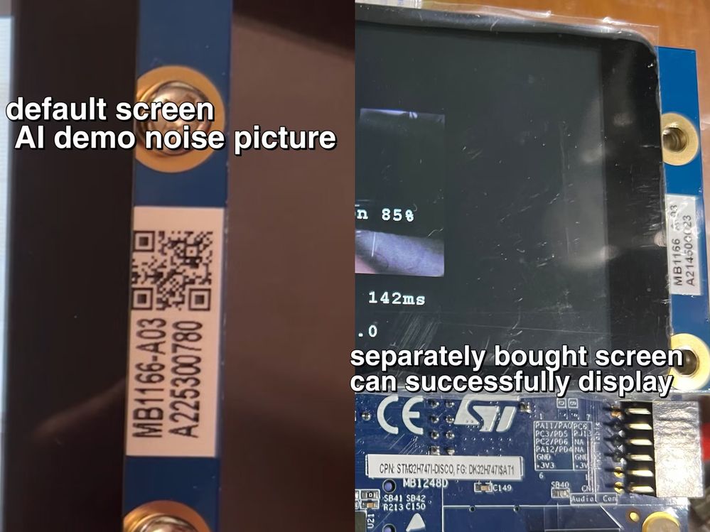

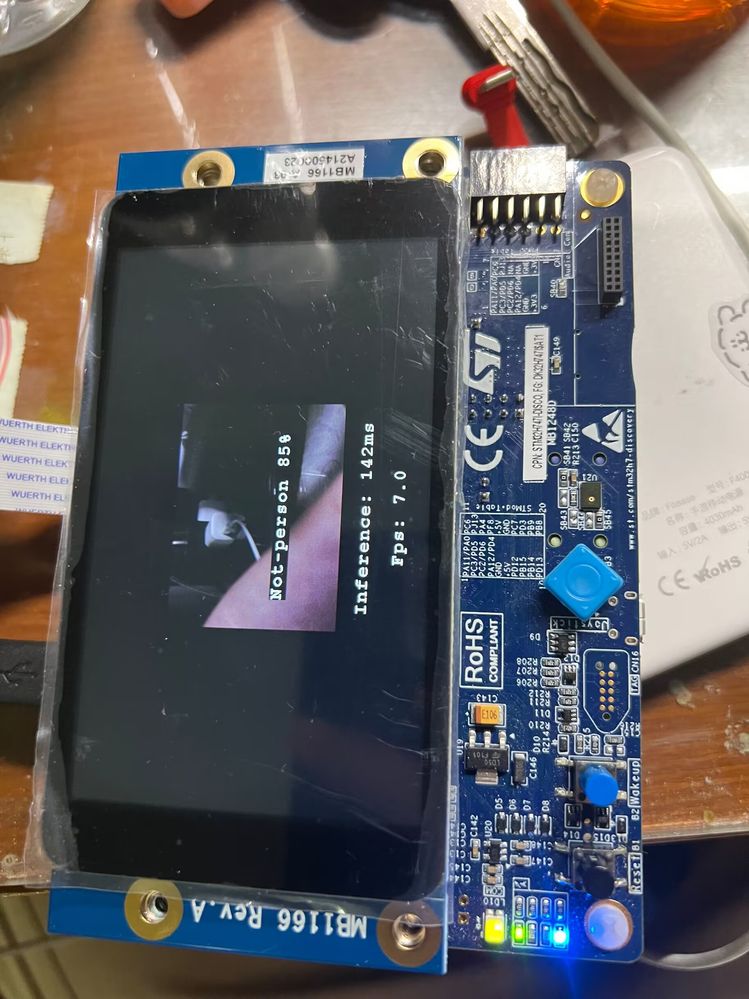

Hey Guys, GOOD NEWS!
​It's the screen hardware problem, I bought a separate screen (B-LCD40-DSI1 4" WVGA TFT LCD) from mouser, which is same type but can normally display.
↓ difference between default screen and separate screen↓ package of screen module
↓ FP-AI-VISION demo:person detect

‎2023-03-07 1:00 AM
Same issue here as well, the BSP code just doesn't seem to work.
Most of the cube examples just do not work for me.
‎2023-03-07 9:58 PM
Ok I have looked into this a bit and as far as I can see so far is that any example that uses DSI Video mode doesn't work, any that use DSI Command mode do work.
So at a guess the BSP DSI Video mode code is broken for this board.
I'm thinking maybe we have a new version of the board.

I tried the LCD_DSI example (and other demos) and it works on STM32H747 board with D01 revision/ LCD Rev A03
which demo are you using exactly? which board revision? And which LCD revision?

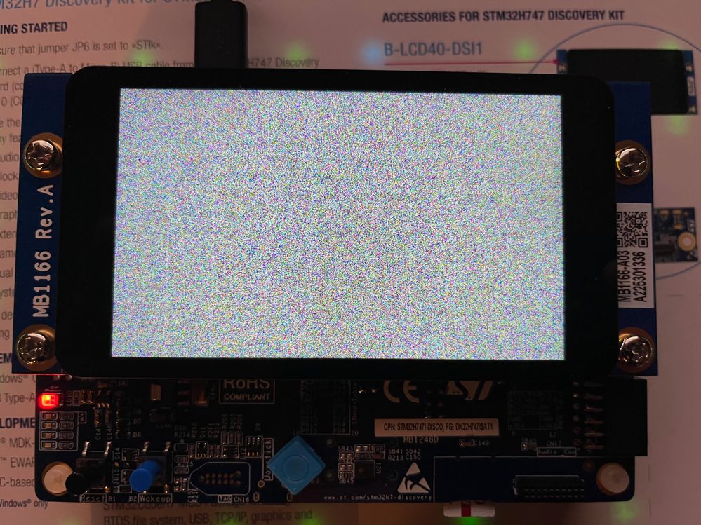

‎2023-03-10 8:22 AM
Hi Sarra, I think myself and BTUrc.2 have the same version looking at his image.
I have attached a higher res image where you can see the stickers.
