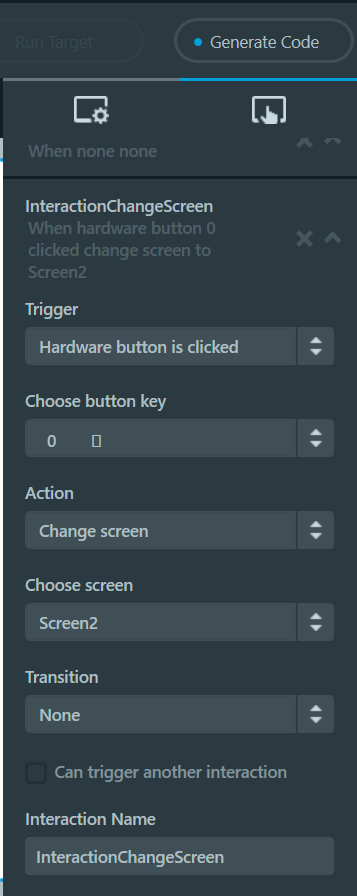

I have a counter in main.c. I have two screens A and B. The meter reading is sent to screen B and displayed. When the counter reaches 0 I want screen B to switch to A. How to set it up in GFX? greetings

I would advise to create an Interaction within TouchGFX Designer where you set as Trigger "Hardware button is clicked" (a dummy button that you will not set) and as Action "Change screen". With this will be generated in <nameOfScreen>ViewBase.cpp a function called application().gotoScreen2ScreenNoTransition(). It will have a different name if you use another transition or have another name for screens. You can then call this function in your <nameOfScreen>View.cpp when the counter reaches 0.

What I had in mind was just to have a fake hardware button and interaction, and then add in screenCurrentView.cpp the following function where you check all the time if the conditions are met or not to then call the changing screen function
void ScreenCurrentView::handleTickEvent()
if(!min_current && !sec_current)
application().gotoScreenSetScreenNoTransition();

You forgot to add it to ScreenCurrentView.hpp
#ifndef SCREENCURRENTVIEW_HPP
#define SCREENCURRENTVIEW_HPP
#include <gui_generated/screencurrent_screen/ScreenCurrentViewBase.hpp>
#include <gui/screencurrent_screen/ScreenCurrentPresenter.hpp>
class ScreenCurrentView : public ScreenCurrentViewBase
public:
ScreenCurrentView();
virtual ~ScreenCurrentView() {}
virtual void setupScreen();
virtual void tearDownScreen();
virtual void updateMinCurrent(uint8_t min_current);
virtual void updateSecCurrent(uint8_t sec_current);
virtual void handleTickEvent();
protected:
#endif // SCREENCURRENTVIEW_HPP
