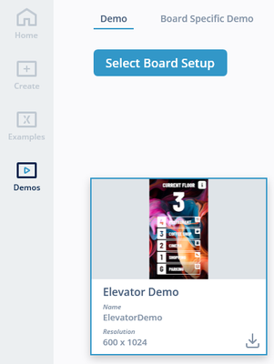

JohanAstrup
Hello @BlazK.
For reference, you can have a look at the Elevator Demo available in TouchGFX Designer.
A drag threshold is implemented in the main screen. I have inserted the relevant code below.
void MainScreenView::handleDragEvent(const DragEvent& evt)
    if (scrollList1.getIsScrolling() == false && abs(evt.getNewY() - evt.getOldY()) < 4)
        // Ignore initial drag if too small. This is to avoid accidental scrolling
    else
        dragEventHappened = true;
        MainScreenViewBase::handleDragEvent(evt);
However, the best method to implement the drag threshold depends on your specific requirements, so please elaborate on your needs. Should the threshold e.g. apply to all drag events, or only on specific widgets?
