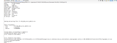

I am using STM32H750IBT6 with MT25QL512ABB8ESF-0SIT QSPI flash IC for external memory and IS42S32400J-6TLI as SDRAM, on a custom PCB with an LCD screen. Using TouchGFX.

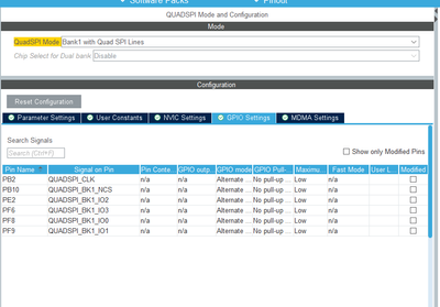

QSPI pinout is as follows:
I've edited the FLASH_Id script - added as a .c file as an attachment.
I would prefer to not use a bootloader, but if that is the only way or quickest way to get this working then please let me know. I have looked at using external loaders but as the pin out of my QSPI is slight different, external loaders will not be compatible.
My code compiles but it does not flash:

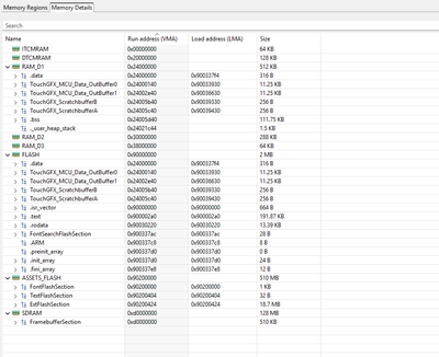

Under 'ASSETS_FLASH', ExtFlashSection does appear as expected after loading images onto TouchGFX.
If you have any suggestions why I can not flash the external QSPI flash IC, please let me know.

Your flash is not 512MB big, it is 512 M bits = 64 MBytes. This is likely the reason why the ext. flash loader failed.
The SDRAM is 128 M bits = 16 M bytes, not 128M.
The execution always starts in the internal flash at 0x08000000, so you can think of the startup code as of bootloader, and it is necessary to activate the external memories before the app can run.

Hi @AEng7 ,  STM32H750 belongs to the "old" family of STM32H7. Its closest relative is STM32H753 (and STM32H743) which has a simple QSPI only. It has very small internal flash similar to newer H7R/S, but it wasn't called "boot flash" then and examples and tools for H7R/S do not support it. Ext. loaders and "drivers" for STM32H753/743 should help.
