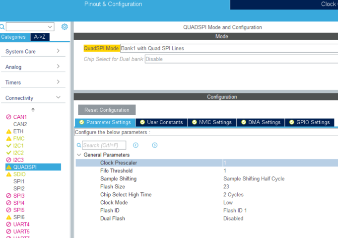

‎2019-11-13 11:01 AM
Hi Martin,
The project trend is as follow:
STM32CubeMX (V5.4.0)
Board Select (STM32F469) (STM32Cube_FW_F4_V1.24.1) + default Discovery pin configuration
Set CubeMX to generate code for CubeIDE with seperate *.c and *.h file
Set Hardware Configuration and Execute TouchGFX (V4.12.3)
Draw some Box and add some Scaled Pictures
Return to CubeMX and regenerate program then open project in CubeIDE
Exclude Simulator files from build (I don't add "***_ts" files yet)
Some problem with MX_FREERTOS_Init and GRAPHICS_MainTask, I add a header to project with following code and include it in "Main.cpp", "freertos.cpp", and "BoardConfiguration.cpp"
#ifndef SharedHeader_H
#define SharedHeader_H
#ifdef __cplusplus
extern "C" {
#endif
extern void MX_FREERTOS_Init(void);
extern void GRAPHICS_MainTask(void);
#ifdef __cplusplus
#endif
#endif /* SharedHeader_H */
Finally I add two line in FLASH *.ld to address QSPI memory:
QSPI (rx) : ORIGIN = 0x90000000, LENGTH = 16M //Added to Memories definition
ExtFlashSection : { *(ExtFlashSection) } >QSPI //Added afeter ARM attributes
Then I compile and download the program. All 4 LEDs are still on and screen is black.

‎2019-11-13 02:49 PM
Hi Matrin,
I do some modification and run everything again. It turns out the black screen is due to the Box in black in my splash screen. I changed the color of the Box and the it works. BUT now I think I find the problem and need your help to solve it. The problem is QSPI memory. It seems when TouchGFX wants to load assets from external flash, it faced with hard fault.
In my splash screen there is a LOGO image which it must be faded in after 1-sec. Splash screen loaded and then stuck there. When I delete that LOGO application works fine. That's why I suspect the external flash.
The linker code if as follow

The linker commands are borrowed from original firmware.
I add some screenshots of my QSPI setting. It maybe worth to note that I enabled QUADSPI global interrupt.
‎2019-11-13 05:53 PM
Hi again Martin,
I take one step more. I add External Loader to Debugger.
Now it seems debugger do some modifications on external memory. After it finishes the downloading process my application runs very well. :)
The most awkward thing is when I reset the board it does not work again and it stuck at somewhere that screen shows salt-and-pepper noise. :\
Any suggestion?
