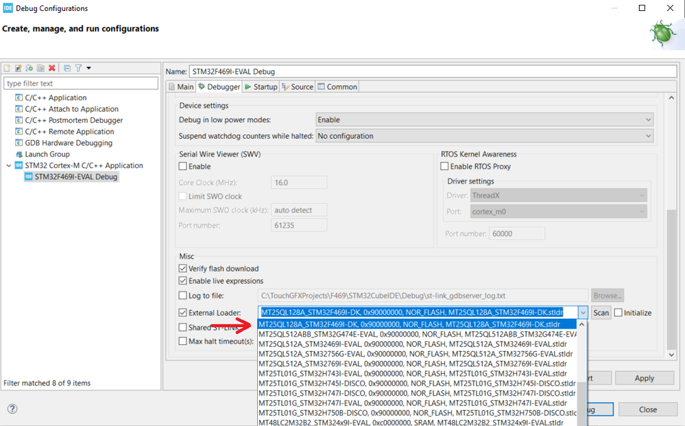

I am creating a project for the STM32F469I-DISCO board, and trying to open it and build it in STM32CubeIDE. It appears that TuchGFX Designer is not creating correct file names. Some have -EVAL instead of -DISCO, and I think this is causing problems. You can see both in the project below. All I did was open the .cproject file in the TouchGFX project folder. It does not find the ioc file, because it is incorrectly looking for a -EVAL and the actual file is a -DISCO file.
I'm assuming this is a bug in TouchGFX Designer because it is mixing up the two types of boards (-DISCO and -EVAL)?

Try to:
1- Generate code with CubeMx using STM32F469I-DISCO.ioc file
2- From TouchGFX designer, generate the GUI code.
3- Build the application with CubeIDE
If it didn't work, restart from step 2.

It built, but it doesn't run. I get a lot of ST-link activity like it is programming flash, then it says:
Debug connection lost.
Shutting down.
mƎALLEm
I don't have this STM32F469I-DISCO board to test.. but please check the flasher configuration in CubeIDE and select this one:

From TouchGFX, when you select the STM32F469I-DISCO board, before you click Create, change the Versions option from 3.0.5 to 3.0.4.
From CubeIDE, when you click on the Run icon (white arrow on green circle) it will write to flash and exit with the target running. Instead of Run use the Debug button (bug icon) to enter debug mode.

After getting the bad background color from using version 3.0.4, I went back to my original project and repeated what SofLit suggested (at least part of it - the flash configuration that was pointed out did not exist). This time I was able to compile with no errors and run the debugger.
