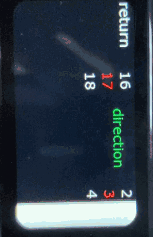

The screen tearing issue is as below. It looks always appear in the right area:

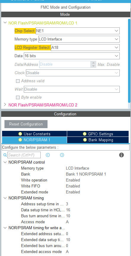

0693W000006GwEqQAK.gif​The screen is FMC16 bit parallel port, and the parameter is as below:
0693W000006GwKFQA0.pngAnd the screen has TE signal, the TE Interrupt function is an below:

Can anyone tell me what caused the screen to tear? And can I avoid it by program.​

Are you sure it is related to FMC ?
What MCU do you use ? Is the white box part of your GUI ?

I don't know if the FMC related to it.:sad_but_relieved_face:
The MCU is H750VBTx, and the white box is the part of my GUI, I write it for observing the tearing phenomenon.

What is the resolution of your display ?
If your display is an FMC display, it has an embedded GRAM right ?
Do you invalidate the whole screen ? You can check by pressing F2 key on your keyboard when running the simulator.
Tearing effect happens when you have bad synchronization between TouchGFX and your display. It can also happen if the GUI requires too much computing power but this is not the case here.
So actually if your display interface is FMC, you are right to check the parameters for this display. Unfortunately I don't know about your custom display.
Maybe you can refer to the Application Template for L496-DISCO available on TouchGFX Designer. This project uses FMC as a display interface.
/Alexandre

,and I invalidate the whole screen( I change the white box position and invalidate the screen in a tick event).

Hello Wrend.1,
If you don't use LTDC, you should not lock DMA to front Porch. Can you make sure in TouchGFXHAL.cpp in void TouchGFXHAL::initialize() you have the line lockDMAToFrontPorch(false); ?
With a H750 updating an area of 370x170 should be quite easy in terms of computing power, so I believe tearing comes from something else like wrong synchronization between your screen and your MCU.

Yes, I ​do not lock DMA to front Porch. I change the "lockDMAToFrontPorch(false);" in TouchGFXGeneratedHAL.cpp, the tearing still alive.

Wrong synchronization between your screen and your MCU? Your mean is the TE signal from screen? Or another reason.
