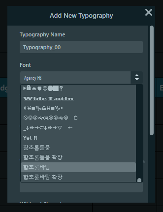

0693W000006HdbOQAS.pngI am using TouchGFX.
There is a font that you need during the design of the screen, so I want to know how to add a font.
In the picture above, you can see many fonts, and all I want is to add a new font to the font list.
The font I am trying to add is Korean font.
And can you tell where the fonts on the list are located on the PC?
Question 1: How to register a new font for a font list item
Question 2: Which folder of the PC are the fonts in the Font list?
I need your help.
1 REPLY 1
Peter BENSCH
To make them available to your project you need to copy your font file(s) to the folder, which is part of your project:
TouchGFX\assets\fonts
Please create the folder fonts if it has not already been created in assets.
Good luck!
