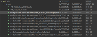

I am working on H750 while the flash is limited.
Because the LCD is RGB565, may I know if the the unrelated functions can be removed? such as functions related with ARGB8888 and RGB888.  Thanks.
Andrei Chichak
Lead II
If you enable optimization then dead code is removed (I'm not sure of the optimization level, but that's a pretty obvious optimization).
If you know of any particular functions that are not used, check your .map file. The .map file will give you the address allocated to the function and if it has been removed, it will not be in the memory map.

The GUI is only a simple button without any photos. The debug information has been disabled since building in Release mode.
The GCC and G++ optimization level is 'Optimize for size (-Os)'. And the Discard unused section in G++ Linker has been selected.
Only the used functions are enabled, such as FMC, I2C(Touchscreen), QuadSPI (to store app), LTDC, FATFS, USB and TouchGFX.
Because the display is set as RGB565. But there are many functions related with ARGB8888 and RGB888. If they can be removed, there should be lots of flash saved.
