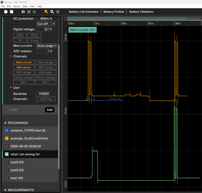

I tried what you suggested as my eighth test: a simple test of the HAL function HAL_PWREx_EnterSTOP0Mode(PWR_STOPENTRY_WFE) .
I configured the PA0 pin (user button 1) first as an external interrupt mode and in a second time as an external event mode (both times waiting on falling edge).
/* USER CODE BEGIN WHILE */ while (1) { HAL_SuspendTick(); HAL_PWREx_EnterSTOP0Mode(PWR_STOPENTRY_WFE); HAL_ResumeTick(); /* USER CODE END WHILE */ /* USER CODE BEGIN 3 */ } /* USER CODE END 3 */ }
I also followed what was already done in the examples from the repository on GitHub.
Unfortunately, it turns out no matter what entry mode (WFI/WFE) I choose, the result is still the same, see screen capture below:
• In green is the current consumption I am aiming for (which I obtained through an error on my wiring: the ST-LINK was still plugged on the board, resulting in a short-circuit).
• In blue is the simplest example (PA0 as an External event, falling edge) with the stop mode entry as WFE.
• In orange is what I got from following the example on GitHub (the dual core one, even though I want a single core version, I tried it anyway).

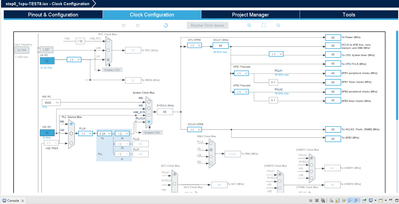

I don't know if I'm supposed to wait for a special flag to be raised/cleared, or if the problem is from elsewhere. Maybe the clock configuration (?), I used the same for every test, see screen capture.
 If any idea crosses your mind, I'm still looking for help.
