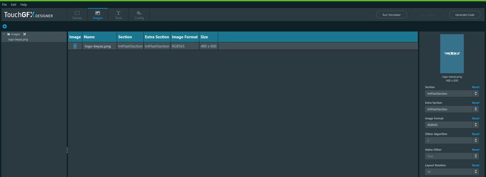

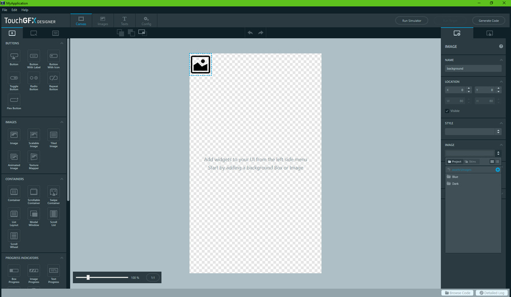

Some thing defenitly wrong with my TouchGFX.
Here is what i am doing:
  • From object list, add an image object to the main screen.
  • Selecting that image object.
  • From right side menu, adding a .png file to my project.
  • From right side Image->Project(tab) i can not see just added png image.
But if i use 4.10.0 version, there is no such problems.
Is this only valid for me?
