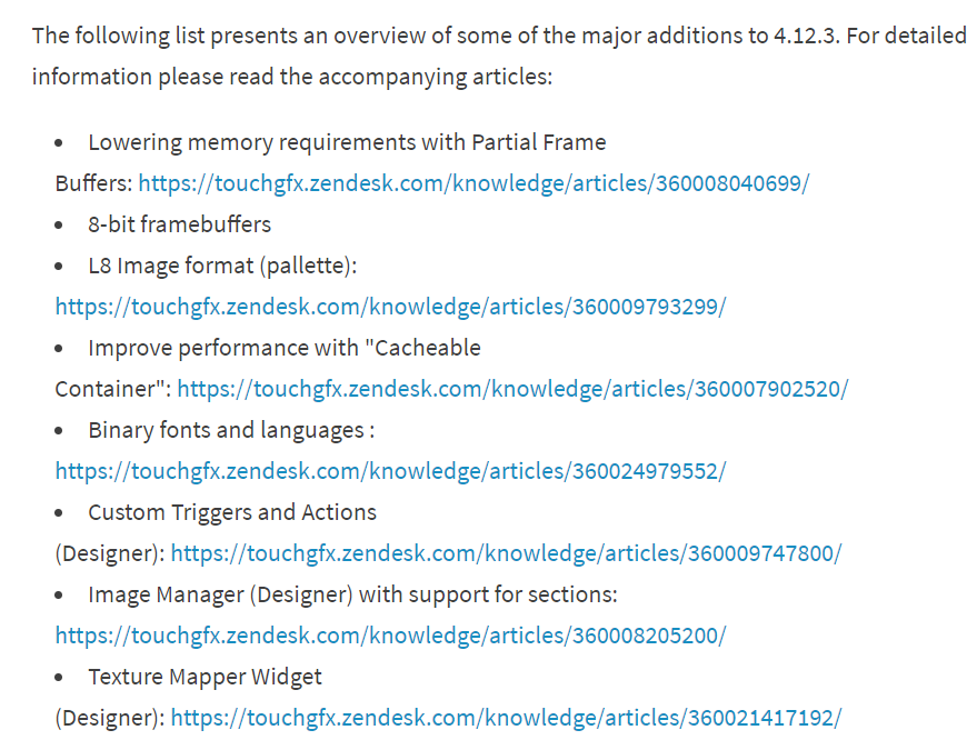

I'm pleased to finally be able to announce the release of TouchGFX 4.12.3, the first official release since 4.10.0. We've worked with CubeMX and CubeIDE to improve the integration experience some, so please get the latest versions of those (5.4.0 and 1.1.0 respectively). For CubeMX, you can upgrade to 5.4 through the software updater, or you can download it from st.com as usual.
Please read the following for an overview.
https://touchgfx.zendesk.com/hc/en-us/articles/360009767400
Teaser:
  • Lowering memory requirements with Partial Frame Buffers
  • 8-bit framebuffers
  • L8 Image format (Pallette)
  • Improve performance with "Cacheable Container"
  • Binary fonts and languages
  • Custom Triggers and Actions
  • Image Manager with support for sections
  • Texture Mapper Widget and more...

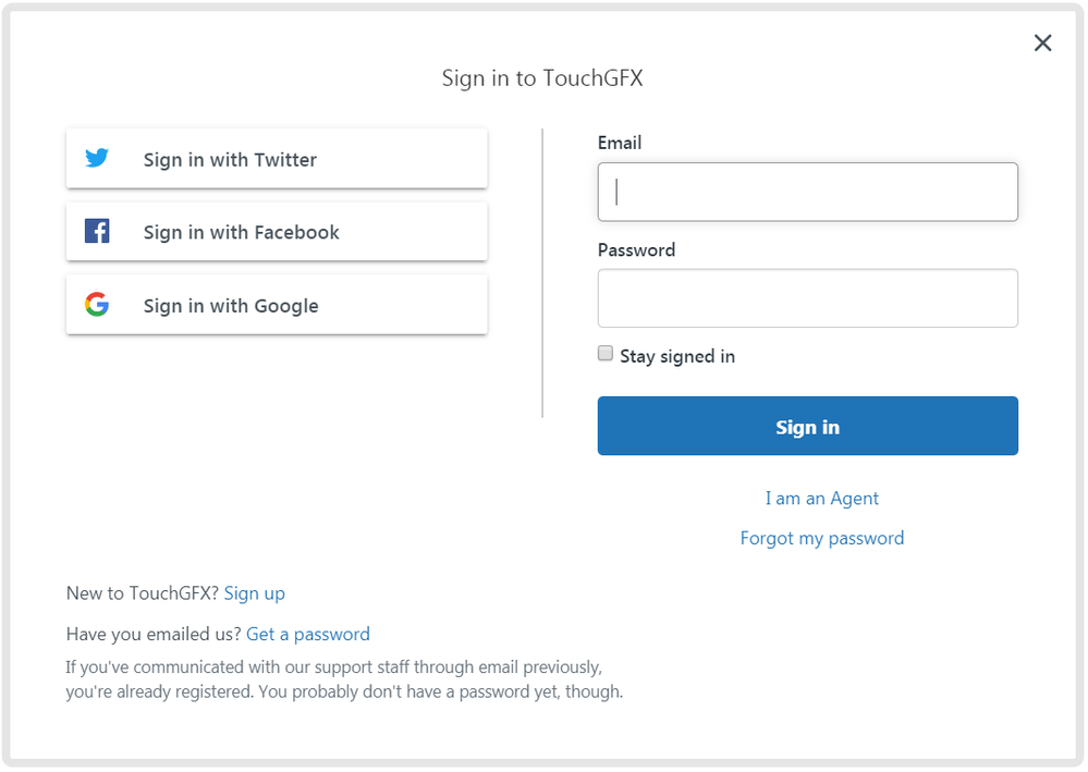

I tried clicking on all of the links to articles on the release announcement page (https://touchgfx.zendesk.com/hc/en-us/articles/360009767400:(
All of them took me to a sign in page:
