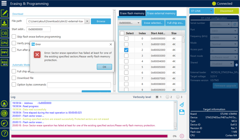

Hello everyone, I've got custom-made board with STM32F407VE and W25Q16 SPI flash with TFT Display installed.
So I've decided to develop my own external loader for SPI flash for storing images in my TouchGFX project. I've managed to read data from flash with st-link utility and stm32cube programmer but encountered some problems.
- Somehow I can erase one sector at a time. But if I decide to erase multiple sectors, only the first sector in sequence will be erased. This works in st-link utility.
- In STM32CubeProgrammer, erase functions doesn't work at all, but I can read the data in memory.
And because of these issues I can't write data to flash, And I don't even know if write function will work, and I still need to figure out how to use it in TouchGFX project.
Edit: It turned out I'm able to erase one sector in stm32cubeprogrammer if I don't do anything except erasing after connecting. If I touch anything before erase command, It fails. Still can't erase multiple sectors at once.
Please help…

Here's CubeProgrammer erase fail screenshot
Solved! Go to Solution.
‎2021-05-14 7:15 AM
Solved.
Init() function called every time before other functions. So SystemClockConfig was called several times, causing a hard fault. I've removed it from Init and erase, read and write operations work fine, but it looks like verify isn't working correctly.
