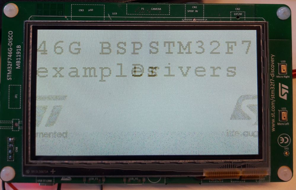

I built the demo below (from STM32Cube-F7) and Flash the .hex file using CUBE-Programmer (with external loader enabled) it to my STM32F746G DISCO.
\STM32Cube\STM32Cube_FW_F7_V1.15.0\Projects\STM32746G-Discovery\Demonstrations\TouchGFX\SW4STM32\STM32746G-Discovery\.project
The display looks like the picture attached. Does anyone recognise this problem ?
(The Hardware is OK … as I can run STemWIn demo fine.)
Any ideas please ?

Before i ask you to send me the hex file did you try debugging? Is the application running but it's just the image on the display that's distorted?

Could you send me the hex file? Just to see if it's a problem with your board. If not, then we can do some more digging, but i wouldn't rule out an issue with the configuration in that cube package.
Could you try creating an application through the designer for the F746G-DISCO? Those templates work for sure.
I'm seeing some patterns on your screen that are reminiscent of offset issues - Do the colors make sense to you when you compare with the assets used in the application?

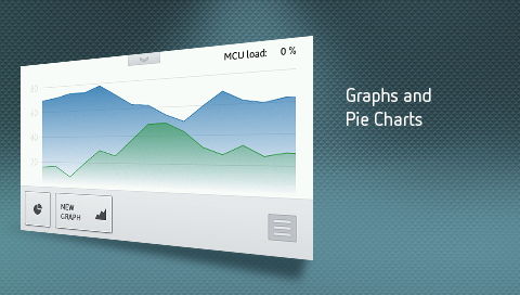

The colours do make some vague sense … and there is a "bar" along the bottom, which looks correct.. See attached asset.

I used System Workbench and got the result in the photo above. Yesterday I used MDK V5 and got a completely different, but still wrong result! See photo below.
