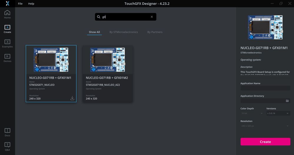

Hello @SafeDev ,
No, you don't need to separate them into two different binaries. You just need to dump both sections into one .elf file. As a reference, you can take a look at the Board Setup available for STM32G071RB_NUCLEO on TouchGFX Designer. There is a similar setup for having Fonts and Images on the SPI Flash.
STM32G071RB Board SetupSTM32G071RB Board Setup
 I hope this helps you,
Good luck
Mohammad MORADI

Hi Mohammad,
well in the end we solved by extract the two files and then merge them with an external tool and it works!
Thank you
Best regards
