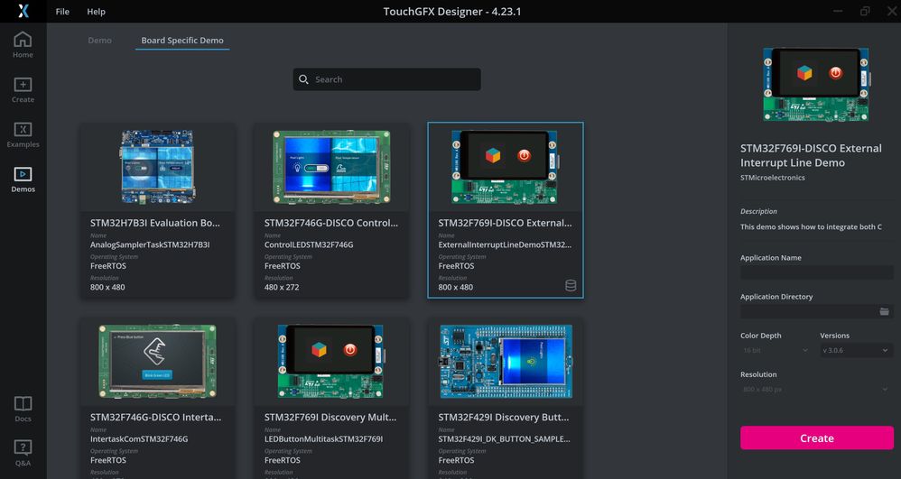

Hello @koderboi22 ,
First of all, I got a bit confused by your statement "I was able to successfully build the Touch GFX project and was able to access the 'gui' folder generated by the designer", are you trying to create a custom project yourself? Or are you using the available board setup in TouchGFX Designer?
And for the error you mentioned, you need to define some functions in the Model that will interact with MAX31856, and then, you need to call those functions in you Screen1View.cpp.
You can check the available Board Specific Demos to get inspiration for your project because they show how you can interact with the rest of the board.
I hope this helps you, don't hesitate to ask more questions.
