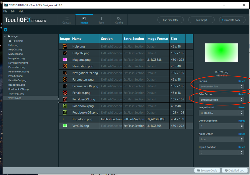

You then go to touchGfx designer to tell where your image data are stored like in the screenshot below
You have to know that an image may be cut in two parts depending on its format. That's why you have 'Section' and 'Extra Section' (surrounded by red ellipse). The 'Section' part are the actual pixels of the image and it's the only used part if your image is a non indexed format (RGB888 , RGB565, ARGB8888 ...) , with these formats the 'Extra Section' is not needed to store the image. But, if your image has an indexed format (L8_RGB565, L8_RGB888 ) these formats need a CLUT (Colour lookup table with the 256 colours used in your image) .. and this CLUT is stored in the 'Extra Section'. In the screenshot my image is an indexed L8_RGB565 and I ask TouchGFX Designer to put both pixels and CLUT in 'ExtFlashSection' (The name of the section we find in the Linker file above)
If you compile the code generated with this configuration and the modified linker file and look at the map file searching the name of your image (In my case it's Vert256) you should find lines like this ...
ExtFlashSection
0x0000000090061018 0x1fed4 TouchGFX/generated/images/src/Vert256.o
0x0000000090061018 _vert256
0x0000000090080e18 _vert256_extra_data
That means that the two parts of the image are mapped at addresses above 0x90000000 (FYI _vert256 are the Pixels, _vert256_extra_data are the CLUT)

In this last case the map file should show something like :
ExtFlashSection
0x0000000090061018 0x1fe00 TouchGFX/generated/images/src/Vert256.o
IntFlashSection
0x000000000806ef4c 0xd4 TouchGFX/generated/images/src/Vert256.o
0x000000000806ef4c _vert256_extra_data
Showing that the extra part (the CLUT) is now placed in the Internal CPU Flash ans thus can be accessed directly by the library avoiding the HardFault
