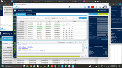

After assigning NOR Flash space in the linker, I created an external loader, tested it, and debugged it in CubeProgrammer. @SofLit  suggested to seek help regarding my TouchGFX-related query in a new thread.
Is there any reference or guide available for implementing FMC NOR Flash in a TouchGFX project within CubeIDE? I added my own loader in the debug configuration and debugged it, but no data is shown on the display, nor is anything visible at 0x60000000 in the memory browser.
Please guide me on how to achieve full access via Flash memory.

Hi @GaetanGodart @Tesla DeLorean @SofLit  , Here's an update regarding FMC NOR flash: I was successfully able to run NOR flash after changing the NOR flash IC from 1 Gbit to 128 Mbit. I replaced it with the same 56-TSOP package. Now, I can load TouchGFX data into my NOR flash. Thank you for guiding me for such a long time. i found data mismatch error in 01 gbit norflash, where full data is not loaded properly, after changing 128mbits  flash, i can get full data exactly.

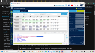

No, I didn't manage to make it work. I compressed the image as much as possible to fit it into internal flash, but I still need external memory to store additional data. Today, I realized a few reasons why I was unable to work with NOR flash. I discovered that my external loader was not created properly because I only tested full chip erase and assumed the loader was fine. I followed a guide and finally got the LED to blink, which is how I tested read and write operations before using the loader. Then, I modified only the loader_src.c file from a GitHub project for the NOR flash used in the evaluation board (M29W128GL), changing the size and name to create a loader for my NOR flash (MT28W01ABA). With this loader, I was able to read, write, and perform a full chip erase, but not a sector erase. finally, got error before debug as data is mismatched like 0xff instead 0xe1..(pic attached).. should I create a each and every step as said  here, but this is for qspi.? did anyone followed this for fmc_norflash..? Should I use IAR or CubeIDE? How do I handle FMC-based flash rather than QSPI?
