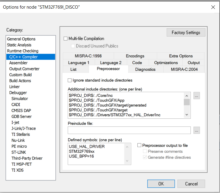

In both EWARM and uVision, I managed to add all the include directories so that the projects could at least find all the .hpp files to try and build.

That is strange, normally you could have use the TBS without including any files. You created your project from a TBS (TouchGFX board setup) right? I just tried with the latest version of TouchGFX (4.21.1) and I can compile a simple GUI on IAR and Keil without issues.
Can you try to create an new project based on STM32F769I Discovery TBS and then "Edit>Import>Import GUI" and select one of the examples suggested. Click on generate code on Designer (F4 shortcut), and then open STM32CubeMX and generate code on EWARM for example. Then, you must regenerate from TouchGFX Designer again, before trying to compile on IAR (same with Keil).
Concerning the log output you're referring (Error[Li005]: no definition for "BitmapDatabase::getInstanceSize()" [referenced from ...) I guess what's missing is the path in the preprocessor configuration. But that shouldn't happen if you create your project the way I described.

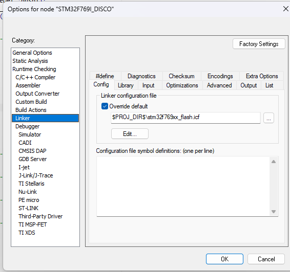

And for the other error (Error[Lp011]: section placement failed
      unable to allocate space for sections/blocks with a total estimated minimum size of 0x19'00d0 bytes (max align 0x8) in <[0x2000'0000-0x2007'ffff]> (total uncommitted space 0x8'0000).) --> this is a issue with the linker script, but the linker scripts we're providing in our TBS is configured to have enough space. So unless you're not including multiple huge images, it shouldn't happen.

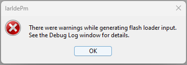

Thank you for your reply. I followed the STM32 Graphics: How to use IAR EWARM with TouchGFX templates - YouTube video and managed to build the project just fine. The problem I now have is in uploading the code to the development board. I'm using one the standard templates from TouchGFX Designer (SVG Image Example).
I have tried to follow your method and the project builds just fine, but I'm still having problems uploading the code to the development board.

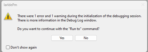

The first error/ popup I get is 0693W00000Y8uQMQAZ.pngfollowed by

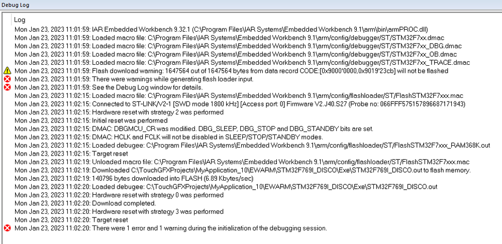

0693W00000Y8uQlQAJ.pngLooking at the debug log I get
0693W00000Y8uRPQAZ.pngJust in case you can't read the text, I get this:
Mon Jan 23, 2023 11:01:59: Flash download warning: 1647564 out of 1647564 bytes from data record CODE:[0x9000'0000,0x9019'23cb] will not be flashed
The settings for the linker is as follows
0693W00000Y8uS8QAJ.pngand I'll attached the file and stuck a .c on it in order to upload it.
