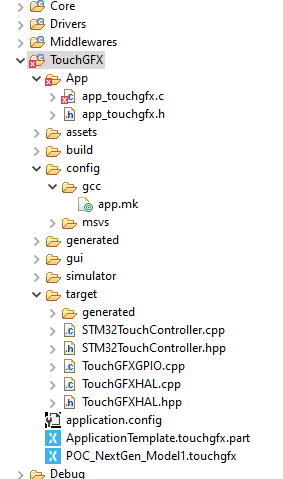

I'm working on a project using touchGfx and expected to be running on a WB55 processor (this is not important, except for that there is no WB55 based existing demo for touchGfx).
So i used STM32MX to configure some basic items, amongst which the fact i'm using Touchgfx.
Then i went into TouchGfx Designer to design the UI interface and flow.
The code compile and works perfectly as long as i was building for the simulator.
Now that i"m happy with the result in the simulator, next step is to compile and run for the hardware target based on WB55.
I know i'll soon or later have to write some low level code for instance for the LCD display and the TouchScreen, but i wanted to already get a first compile ( even not working or even with some errors) from STM32IDE. So i went into STM32MX and generate code (again, just in case).
Then i launch STM32IDE, import the project. I can see all the files (core, drivers, middleware, touchGfx) and inside TouchGfx i see all the files i wrote that are running fine with the simulator.
The problem is when i start compiling, almost no files from TouchGfx are being compiled. The drivers compile, the Core compiles, the touchGfx/App/app_toucgfx.c is being compiled. But none of the files inside TouchGfx/generated or TouchGfx/gui or TouchGfx/target are beling build/compiled and of course the build process fails because of undefined references.
So my question is how can i build my project (using touchgfx) from STM32IDE ?
Btw, i also tried to generate the code for IAR (>8.20) and there also all the TouchGfx related files are not compiled (they even don't appear in the project view.

I think i could solve my issue, thanks to you.
As suggested i started a new minimal project to demonstrate the issue and, o suprise, there it works.
So i started to compare that project with my project having the issue and i saw that there were actually 2 .project and 2 .cproject file .
One set of file is located in project/STM32CubeIDE and i believe this is the right place and there was another set of files in project/ (project top level directory). I deleted those 2 files and suddenly it compiles fine from inside STM32IDE !
Thanks for the support. I must admit i was probably too lazy to make the new project by myself, so thanks for pushing me doing it :)

To come back to my current issue. Here is the output of the build console (cleaned up and shortened to fit in this post):

As you can see some Drivers are compiled, as well as some "Cores" stuffs and the file ../TouchGFX/App/app_touchgfx.c But none of the other touchgfx related files gets compiled, although they exists (there are lots of cpp files in TouchGfx/generated, TouchGfx/gui, ... that are not compiled):
I supose i could try to understand what's missing in the makefiles but i'm pretty there must be some action i should do so that the ecosystem takes cares of this for me. I just can't figure out what i do wrong.

In the touchGfx folder i have actually 2 touchgfx "designer" files:
- ApplicationTemplate.touchgfx.part
- POC_NextGen_Model1.touchgfx
As i was not sure which one to open i tried with both.
Which one should i use ? and what is the purpose of the other one ?

Sara,
"Generate under root" is not checked.
