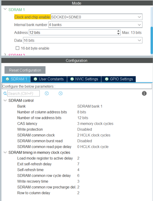

I have this embedded display with resolution of 800x480, MIKROE-3620 which host at the back the STM32 MCU and many other features. I chose the STM32F746ZG as the MCU.

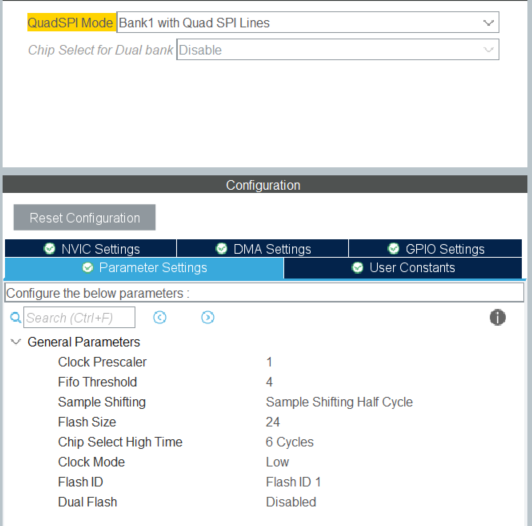

At first I created the project with MXCube, added TouchGFX component, build the project on Cube Ide, then I set the screen with TouchGFX and build it all with no error. The display is still black with no response. I also followed video, setted the SDRAM and QUADSPI, otherwise RAM and FLASH would overflow, but still no response.

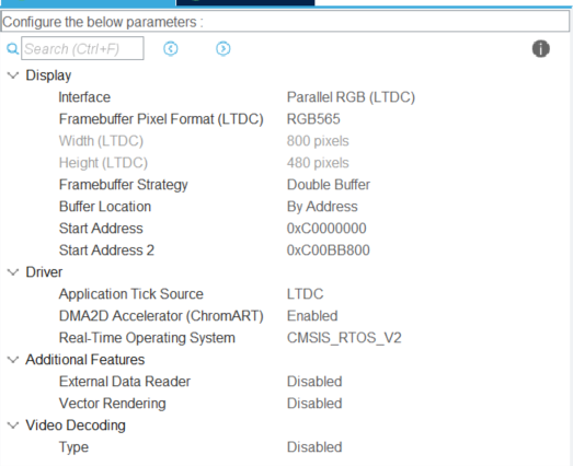

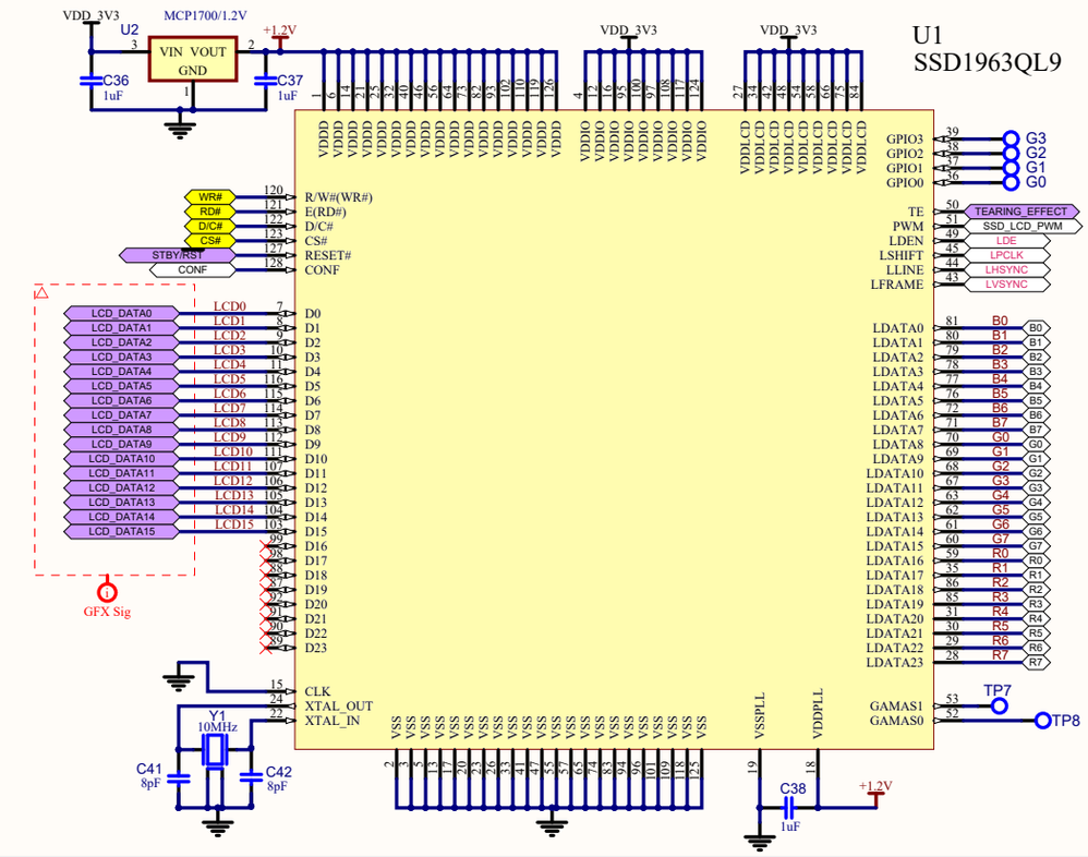

I saw in many videos or documentation the use of LTCD periphery to control TFT display. Is it really necessary in my case, since the board has already a graphic driver? Here's the schematic of the display provided from the company. Even more, I'm afraid that when I activate LTDC, it selects pins that are assigned to others.
I also don't understand the communication protocol of the display. On the manual says that the touch control uses I2C communication, but I don't understand which communication protocol use the display?

Here are some screenshot of SDRAM, QUADSPI and TouchGFX settings. I also uploaded the project.
What I'm doing wrong or I'm missing something?

Doesn't it use an SSD1963QL9 with 1.2M of internal frame buffer?
https://www.arrow.com/en/products/ssd1963ql9/solomon-systech
Examples from MikroE would be more appropriate than the STM32F746G-DISCO, which drives that screen from an SDRAM based frame buffer, and parallel RGB signals to the display. ie LTDC rastering data from local memory.

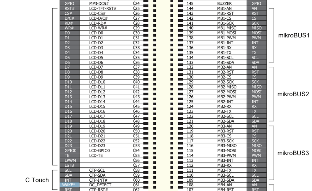

Yes, exactly. It uses SSD1963 LCD display controller. In fact, as the picture shows:
The LCD_DATA[0-15] (marked with dotted res rectangle "GFX Sig)), WR#, RD#, D/C#, CS# (labelled in yellow) coincide with the pins of connector CN5 of the schematic.

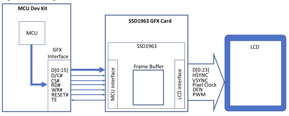

I toook a look on the datasheet and still is not clear how to deal with the chip SSD1963. So far I understood, that I need to deal with a few pins, that are D[0:15], D/C#, CS#, RD#, WR#, RESET#, and TE, as the picture from the pdf shows:
_legacyfs_online_stmicro_images_0693W00000biA0HQAU.pngBut how? The datasheet a long command table and description, but I'm confused how to use it....
It also talk about a framebuffer, but how to set it and pass to TouchGFX and MCU STM32?
