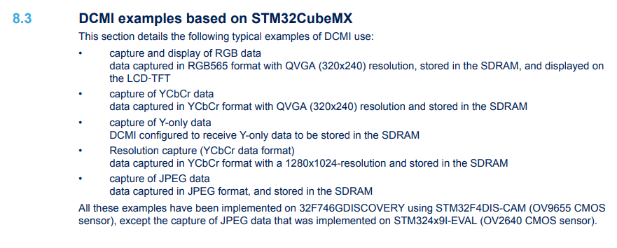

I'm trying to configure the DCMI pheriferal of the STM32F746-Discovery and in AN5020 PDF i find that exist some examples implemented in STM32CubeMx. Where i can find it?
I don't find the examples in the STM32Cube examples.
Foto of the AN5020 examples:
KDJEM.1
Hello @BTurc.2​ ,
The DCMI examples based on STM32CubeMx is detailed precisely in section (8.3.2) in AN5020.
You can follow the steps cited in this application note to configure your DCMI project.
Theses examples are developed with 32F746GDISCOVERY and STM32F4DIS-CAM interconnection for different capture mode (RGB, YCbCr, Y only, JPEG....)
