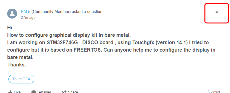

Hi, How to configure graphical display kit in bare metal. I am working on STM32F746G - DISCO board , using Touchgfx (version 14.1) i tried to configure but it is based on FREERTOS. Can anyone help me to configure the display in bare metal. Thanks.

Please don't put the entire post in the Title - see:
https://community.st.com/s/article/How-to-Post
Limit the title to ~ 70 characters.
You can edit it - use this button:

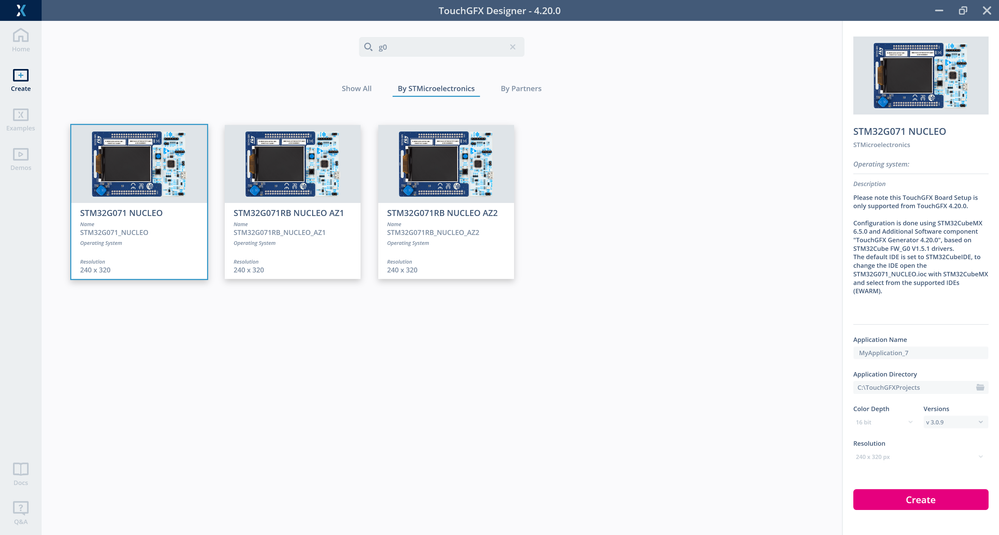

Hello @PM.5​ ,
To configure bare metal on your board, I'd recommend you to take a look a the STM32G0 TouchGFX Board Setup available in TouchGFXDesigner. It already implements that.
/Yoann
