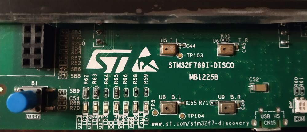

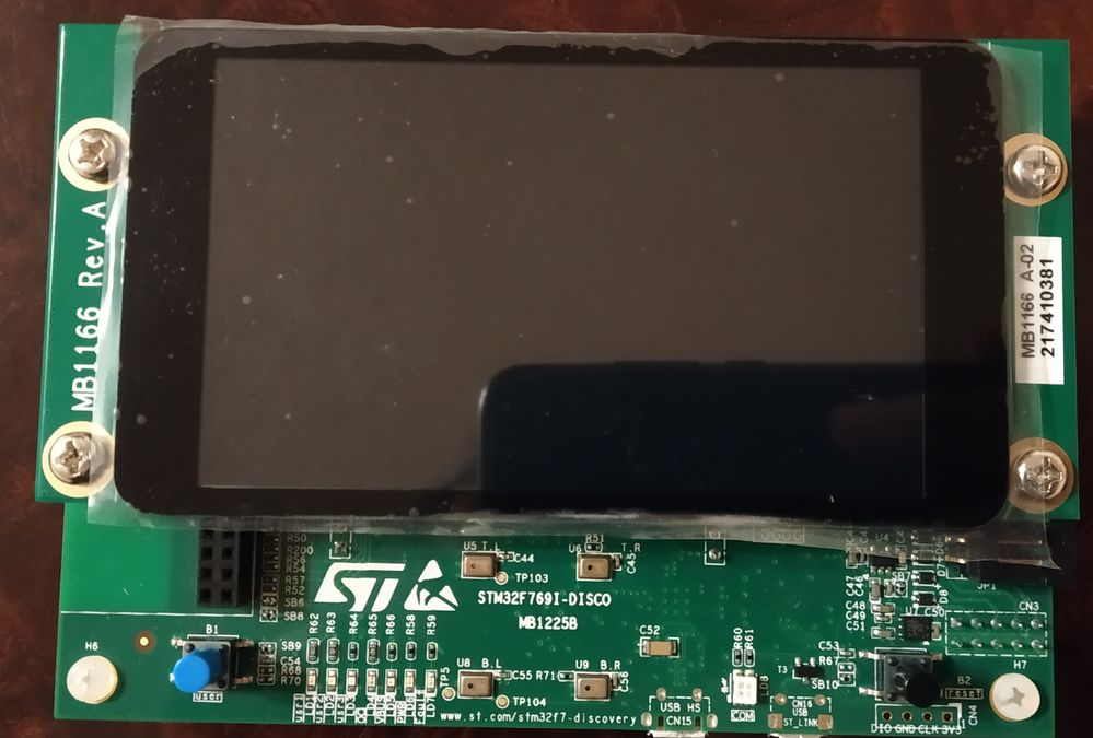

I checked with STM32F769I-DISCO Revision B.
Which Rev are you using ?
Thanks
Imen
I don't know which version is it.
I am sharing pictures with you, maybe helpful.
I see revision A written on LCD but I think it is for LCD not for the ST board.0693W00000JNLcXQAX.jpg0693W00000JNLccQAH.jpg0693W00000JNLcmQAH.jpg0693W00000JNLd1QAH.jpg

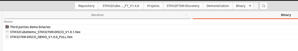

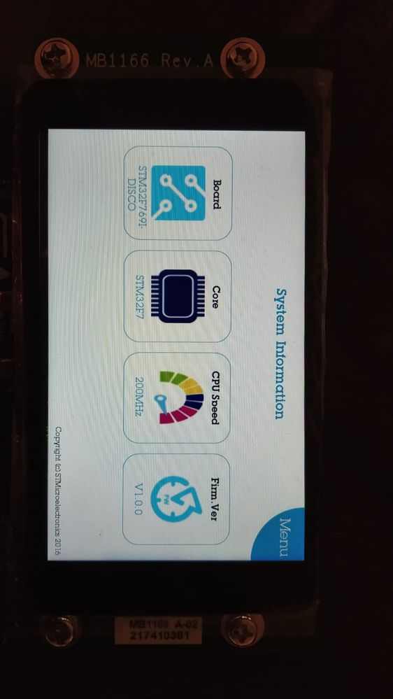

I purchased the board from Amazon.de where the seller was ST. The board comes with a pre-programmed demo and it works fine, and I remember the demo version was V1.0.0, which can be found when we click on "System Information" on the LCD screen.
There is a demo project available named "STemWin" which I think is equivalent to this pre-programmed demo, and when I compiled and programmed this, it works but the display was messy.
After this, I thought that I will use the binaries directly from the ST website and not by compiling myself.
So, I downloaded various STM32CubeF7 packages, and finally, I found the binaries under the following path.0693W00000JNqteQAD.png I used the binary STM32769I-DISCO_DEMO_V1.0.0_FULL.hex because it is version 1.0.0 and it works fine. Screenshot below.

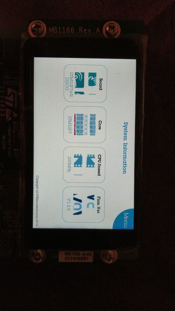

0693W00000JNqtoQAD.jpgBut when I programmed the version STM32CubeDemo_STM32769I-DISCO_V1.0.1.hex, the display was still messy as I have seen when I compiled the demo myself.
I found another version of the demo in the latest version of Repository STM32CubeDemo_STM32769I-DISCO_V1.2.0.hex, and the situation is the same, the display is messy as seen below.

For the display issue with the demo project, it maybe related to the STemwin version, as there is a display issue detected with STemWin 5.40 version and fixed with the STemWin 5.44 version.
Regarding the first issue reported, I have not reproduced it on my side with STM32F769 Rev B, STM32F769-Eval and STM32F7508-DISCO boards.
But this behavior is reproduced for a colleague with STM32F769Disocovery Rev. A board. He checked other boards and it is working like a charm on STM32F769-Eval. Also ported code form STM32F769-Eval to F769-Disco is working.
So, we are still working on the issue and checking this behavior with different boards to identify the related hardware environment.
